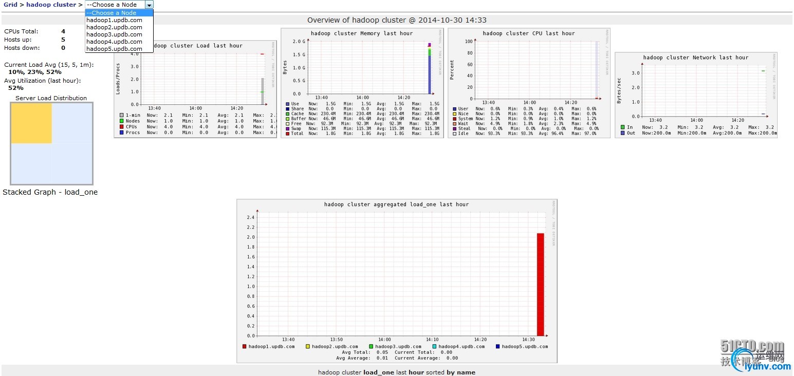

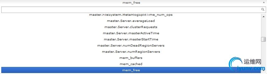

5、在浏览器中访问192.168.0.101:8080/ganglia,就会出现下面的页面

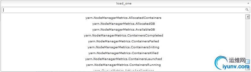

    但此时,ganglia只是监控了各主机基本的性能,并没有监控到hadoop和hbase,接下来需要配置hadoop和hbase的配置文件,这里以hadoop1上的配置文件为例,其他节点对应的配置文件应从hadoop1上拷贝,首先需要修改的是hadoop配置目录下的hadoop-metrics2.properties

    接着需要修改hbase配置目录下的hadoop-metrics2-hbase.properties
9
10
11
12
13
14
15
16
17
18
19
20
21
22
23
24
25
26
27
28
29
30
31
32
33
34
[iyunv@hadoop1 hadoop]# cd /opt/hbase-0.98.4-hadoop2/conf/
[iyunv@hadoop1 conf]# cat hadoop-metrics2-hbase.properties
# syntax: [prefix].[source|sink].[instance].[options]
# See javadoc of package-info.java for org.apache.hadoop.metrics2 for details
#*.sink.file*.class=org.apache.hadoop.metrics2.sink.FileSink
# default sampling period
#*.period=10
# Below are some examples of sinks that could be used
# to monitor different hbase daemons.
# hbase.sink.file-all.class=org.apache.hadoop.metrics2.sink.FileSink
# hbase.sink.file-all.filename=all.metrics
# hbase.sink.file0.class=org.apache.hadoop.metrics2.sink.FileSink
# hbase.sink.file0.context=hmaster
# hbase.sink.file0.filename=master.metrics
# hbase.sink.file1.class=org.apache.hadoop.metrics2.sink.FileSink
# hbase.sink.file1.context=thrift-one
# hbase.sink.file1.filename=thrift-one.metrics
# hbase.sink.file2.class=org.apache.hadoop.metrics2.sink.FileSink
# hbase.sink.file2.context=thrift-two
# hbase.sink.file2.filename=thrift-one.metrics
# hbase.sink.file3.class=org.apache.hadoop.metrics2.sink.FileSink
# hbase.sink.file3.context=rest
# hbase.sink.file3.filename=rest.metrics
*.sink.ganglia.class=org.apache.hadoop.metrics2.sink.ganglia.GangliaSink31
*.sink.ganglia.period=10
hbase.sink.ganglia.period=10
hbase.sink.ganglia.servers=192.168.0.101:8649
    将hadoop1上的这两个文件,scp到hadoop2~5这4个节点上相同的路径下,覆盖原来的文件,然后重启hadoop、hbase,这时ganglia就能够监控到hadoop和hbase了,如下如

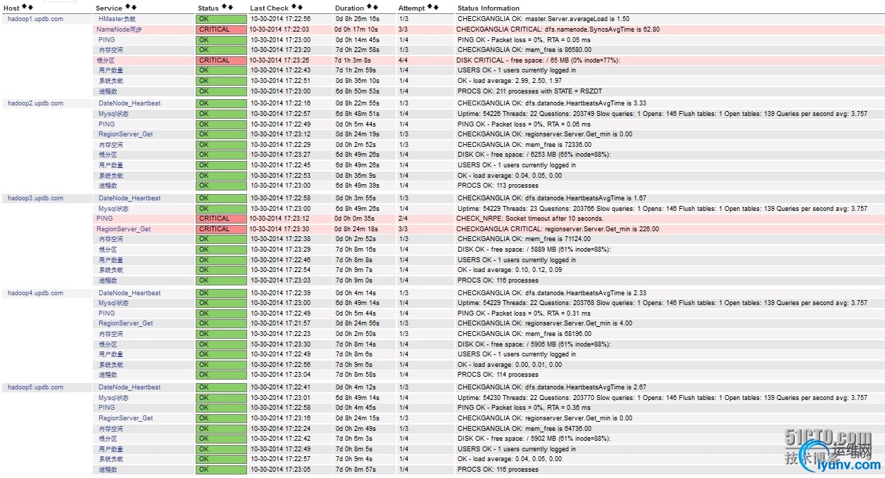

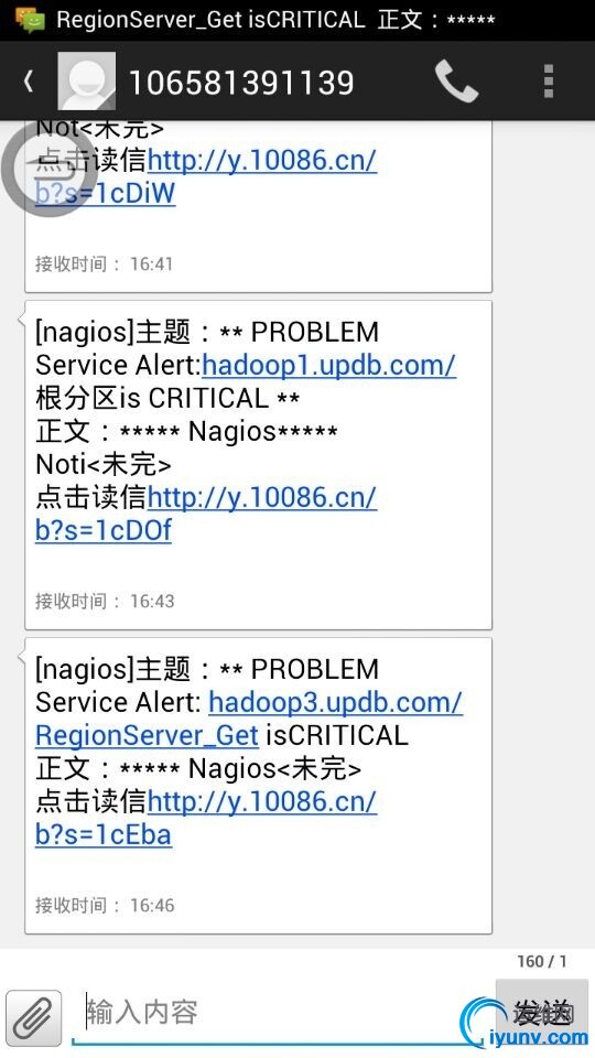

    接下来,安装nagios,在hadoop1上安装nagios服务端、在hadoop2、hadoop3、hadoop4、hadoop5上安装客户端nrpe。
    首先在hadoop1上安装nagios、及相关插件
yum install nagios nagios-plugins nagios-plugins-all nagios-plugins-nrpe -y

    要想让nagios与ganglia整合起来,就需要在hadoop1上把ganglia安装包中的ganglia的插件放到nagios的插件目录下
[iyunv@hadoop1 ~]# cd /opt/soft/ganglia-3.6.0/
[iyunv@hadoop1 ganglia-3.6.0]# ls contrib/check_ganglia.py
[iyunv@hadoop1 ganglia-3.6.0]# cp contrib/check_ganglia.py /usr/lib64/nagios/plugins/
    默认的check_ganglia.py 插件中只有监控项的实际值大于critical阀值的情况,这里需要增加监控项的实际值小于critical阀值的情况,即最后添加的一段代码

    hadoop1上配置各个主机及对应的监控项,有如下配置文件
[iyunv@hadoop1 plugins]# cd /etc/nagios/objects/
## 每个节点对应一个host文件和一个监控项文件,如hadoop2对应的是hadoop2.cfg和service2.cfg
[iyunv@hadoop1 objects]# ls
commands.cfg  hadoop3.cfg  localhost.cfg  service3.cfg  templates.cfg
contacts.cfg  hadoop4.cfg  printer.cfg    service4.cfg  timeperiods.cfg
hadoop1.cfg   hadoop5.cfg  service1.cfg   service5.cfg  windows.cfg
hadoop2.cfg   hosts.cfg    service2.cfg   switch.cfg
    首先在commond.cfg中声明check_ganglia、check_nrpe命令,在文件最后追加如下内容
9
10
11
# 'check_ganglia' command definition
define command{
        command_name    check_ganglia
        command_line    $USER1$/check_ganglia.py -h $HOSTADDRESS$ -m $ARG1$ -w $ARG2$ -c $ARG3$
# 'check_nrpe' command definition
define command{
        command_name    check_nrpe
        command_line    $USER1$/check_nrpe -H $HOSTADDRESS$ -c $ARG1$
    然后修改templates.cfg模版配置文件,在最后追加如下内容

    工作正常,现在我们可以nagios的web页面,看是否监控成功。

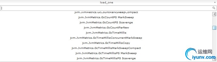

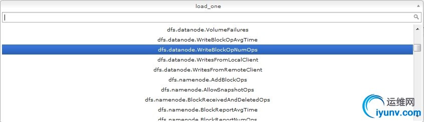

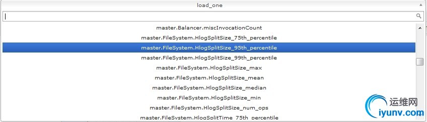

    可以看到已经成功监控,如果需要监控hadoop、hbase更多更加详细的监控项,可以在这里查找,nagios中配置监控项的名字和这里出现的一致即可
    你会发现,ganglia中出现的可监控项非常的多,只要你愿意,你可以监控任何你想要监控的集群选项,前提是要弄明白这些监控项的含义,以及阀值设置为多少最为合适,显然这才是真正的挑战,实验中的集群监控项我是随便选取的,并没有特别的含义,因为鄙人也还是屌丝一枚,正在慢慢学习这些监控项,好了,到这里nagios已经成功监控到了我们想要监控的内容了,那么怎么实现手机短信报警呢?

    重启nagios服务,要保证你的139邮箱开启了长短信转发格式,确保邮件到达邮箱后会转发到你的手机,这里上一张手机接受到邮件后的截图:
