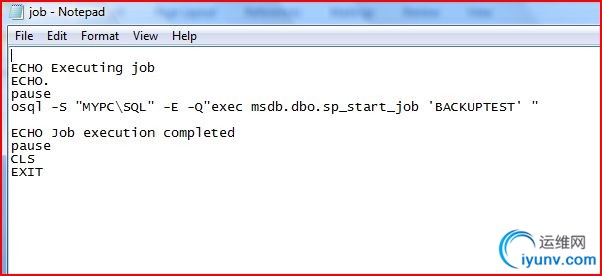

The next step is to make a batch file which can be run over and over again.
Open notepad and type the commands as follow:
Save the file as “job.bat”.
The batch is now ready for use. Just double click on it and it will do the maintenance work without having any knowledge of SQL Server.
