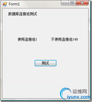

  通过上面的两篇文章希望大家可以明白什么是数据库连接池,什么时候适用,什么时候不适用。关于性能测试,我做了一个小例子,大家可以看看:
  第一次运行:
  多次运行后:
  测试按钮的代码如下:
   1: string connStringUsePool = "server=.;database=pubs;uid=sa;pwd=123456;pooling=true;connection lifetime=0;min pool size = 1;max pool size=50";
   2: string connStringUnUsePool = "server=.;database=pubs;uid=sa;pwd=123456;pooling=false";
   3:
   4: private void button1_Click(object sender, EventArgs e)
   5: {
   6:
   7:
   8:     int count = 50;
   9:
  10:     DateTime start = DateTime.Now;
  11:     for (int i = 0; i < count; i++)
  12:     {
  13:         using (SqlConnection conn = new SqlConnection(connStringUsePool))
  14:         {
  15:             conn.Open();
  16:             conn.Close();
  17:         }
  18:     }
  19:     DateTime end = DateTime.Now;
  20:     TimeSpan ts = end - start;
  21:     label1.Text = "使用连接池"+ts.Milliseconds.ToString();
  22:
  23:     start = DateTime.Now;
  24:     for (int i = 0; i < count; i++)
  25:     {
  26:         using (SqlConnection conn = new SqlConnection(connStringUnUsePool))
  27:         {
  28:             conn.Open();
  29:             conn.Close();
  30:         }
  31:     }
  32:     end = DateTime.Now;
  33:     ts = end - start;
  34:     label2.Text = "不使用连接池" + ts.Milliseconds.ToString();
  35: }
