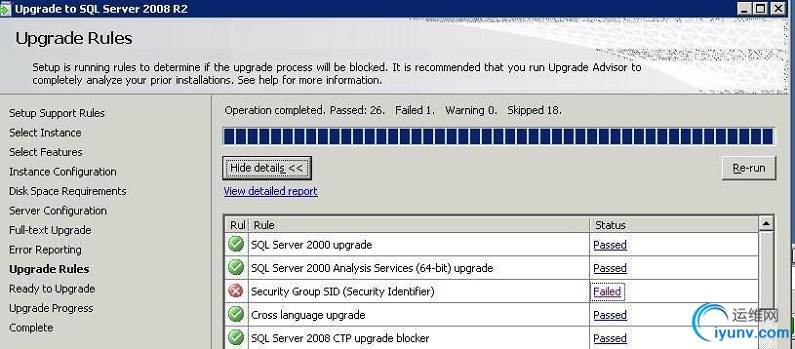

upgrade. Unfortunately, we were not able to complete our upgrade because of a failing a upgrade rule named "Security Group SID (Security Identifier)". The SQL Server Upgrade Setup Wizard did not enable the 'Next' button in order to proceed with the upgrade
until this failure was resolve. In this tip, I will describe the reason for this failure and how I fixed the issue in order to have a successful upgrade.
Solution
  As I described in the problem statement, we were not able to upgrade our SQL Server because one of the upgrade rules i.e. "Security Group SID (Security Identifier)" failed during the setup process. The SQL Server 2008 R2 Upgrade Setup Wizard would not allow
us to proceed and disabled the "Upgrade Rules" page as shown below.
  For the detailed error message, I clicked on "Failed" hyperlink in the status column to read more about the error, but this was not enough to help me understand the issue. Here is the screen shot:
