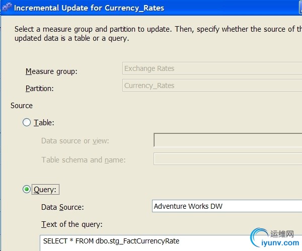

  Step 3: Click the Configure hyperlink in the Currency_Rates row shown in step 2 above.    Since we have selected Process Incremental as the Process Option we need to either specify a table or view to load the new fact rows from or specify a query; we'll specify a query and assume that the stg_FactCurrencyRate table is populated with just the new fact rows to be added to the measure group partition.
