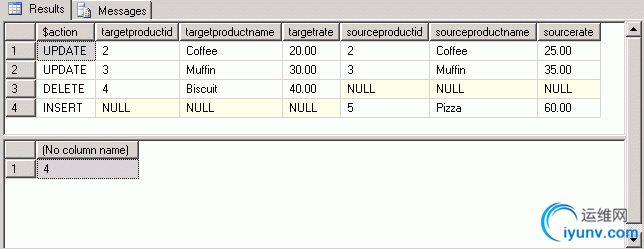

  When the above is run this is the output.  There were 2 updates, 1 delete and 1 insert.

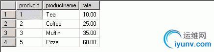

  If we select all records from the Products table we can see the final results.  We can see the Coffee rate was updated from 20.00 to 25.00, the Muffin rate was updated from 30.00 to 35.00, Biscuit was deleted and Pizza was inserted.
