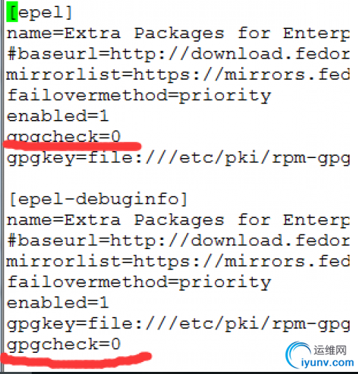

或报错:
运行yum报错Error: Cannot retrieve metalink for repository: epel. Please verify its path and try again
辑/etc/yum.repos.d/epel.repo,把基础的恢复,镜像的地址注释掉
#baseurl
mirrorlist
改成
baseurl
#mirrorlist
再次执行:
yum --enablerepo=epel install heartbeat
