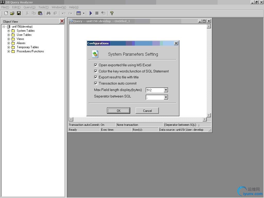

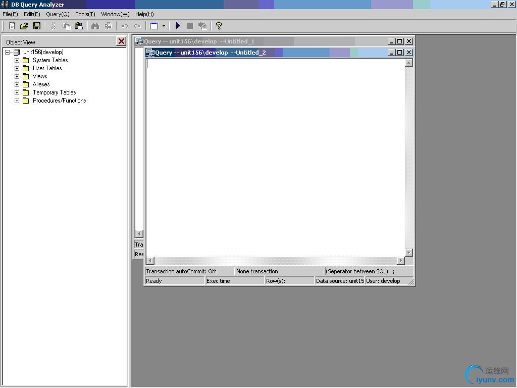

  点击 “Tools”下的“Configuration” 菜单,取消选项“Transaction auto commit”的选中状态。并新建窗口2。这时在状态栏中“Transaction autocommit”已经变成“Off”,见图1、图2所示
  <wbr><wbr><wbr><wbr><wbr><wbr><wbr><wbr><wbr><wbr><wbr><wbr><wbr><wbr><wbr><wbr><wbr><wbr><wbr><wbr><wbr><wbr><wbr><span style="font-size:13px">图1<wbr><wbr> 设置事务提交方式</wbr></wbr></span></wbr></wbr></wbr></wbr></wbr></wbr></wbr></wbr></wbr></wbr></wbr></wbr></wbr></wbr></wbr></wbr></wbr></wbr></wbr></wbr></wbr></wbr></wbr>
  <wbr></wbr>
  <wbr><a href="http://photo.blog.sina.com.cn/showpic.html#blogid=4b70463f0100st8n&amp;url=http://s5.sinaimg.cn/orignal/4b70463fga96b809443c4" target="_blank"></a><br> DSC0002.gif <br></wbr>
  <wbr><wbr><wbr><wbr><wbr><wbr><wbr><wbr><wbr><wbr><wbr><wbr><wbr><wbr><wbr><wbr><wbr><wbr><wbr><wbr><wbr><wbr><wbr><wbr><span style="font-size:13px">图2<wbr><wbr> 打开新的窗口,采用手工提交事务的模式</wbr></wbr></span></wbr></wbr></wbr></wbr></wbr></wbr></wbr></wbr></wbr></wbr></wbr></wbr></wbr></wbr></wbr></wbr></wbr></wbr></wbr></wbr></wbr></wbr></wbr></wbr>

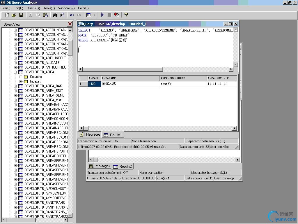

  3.1<wbr><wbr><wbr><wbr><wbr>修改表TB_AREA之前表中的记录</wbr></wbr></wbr></wbr></wbr>
  首先,我们要查询修改DEVELOP模式下修改前表TB_AREA的记录,如图3所示
  <wbr><wbr><wbr><wbr><wbr><wbr><wbr><wbr><wbr><wbr><wbr><wbr><wbr><wbr><wbr><wbr><wbr><wbr><wbr><wbr><wbr><wbr><wbr><wbr><span style="font-size:13px">图3<wbr><wbr> 修改前表TB_AREA中的记录</wbr></wbr></span></wbr></wbr></wbr></wbr></wbr></wbr></wbr></wbr></wbr></wbr></wbr></wbr></wbr></wbr></wbr></wbr></wbr></wbr></wbr></wbr></wbr></wbr></wbr></wbr>

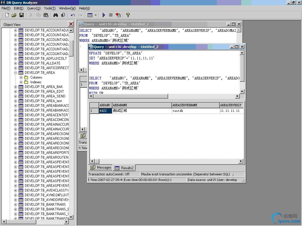

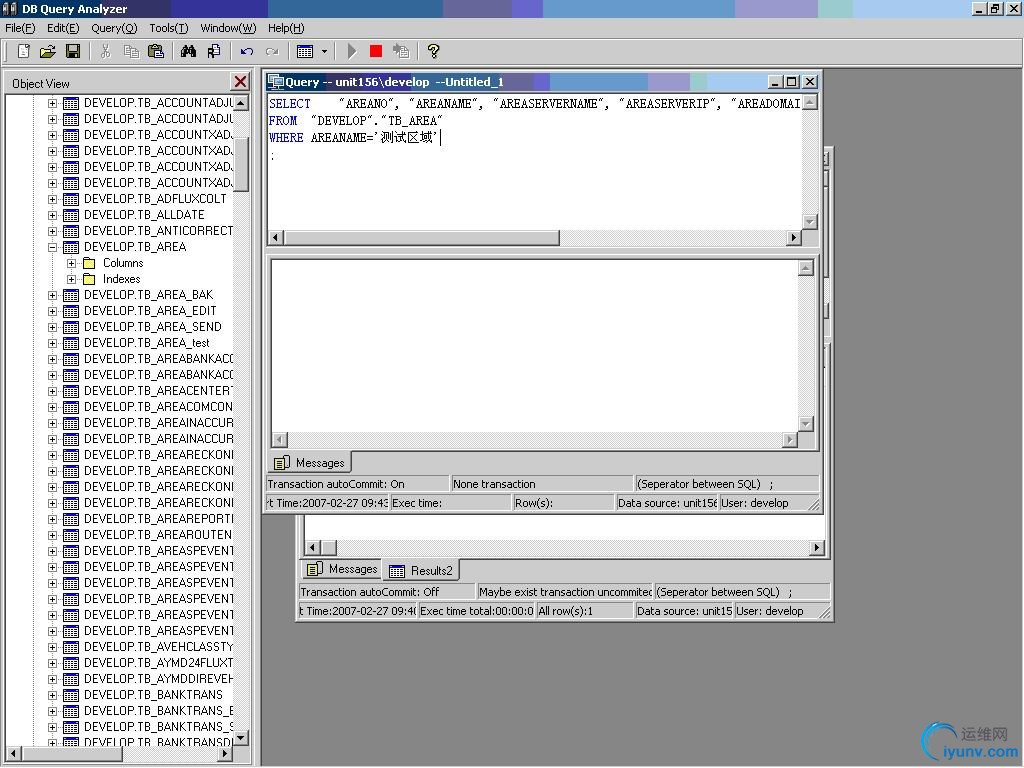

  接着,我们在手工提交事务的窗口2,修改表TB_AREA中的记录,将“测试区域”的AREASERVERIP值由“ 10.10.10.10”改为“11.11.11.11”,并以只读锁来访问表TB_AREA,可以看到窗口2中记录已发生了变化,如图4所示;而再执行窗口1中的查询语句,由于查询时没有加R(只读锁)则查询不到结果,表明表TB_AREA中有未提交的事务,如图5所示。

  <wbr><wbr><wbr><wbr><wbr><wbr><wbr><wbr><wbr><wbr><wbr><wbr><wbr><wbr><wbr><wbr><wbr><wbr><wbr><wbr><wbr><wbr><wbr>图5<wbr><wbr> 表TB_AREA中有未提交或回退事务,所以在其它会话中只能以R锁来查询该表</wbr></wbr></wbr></wbr></wbr></wbr></wbr></wbr></wbr></wbr></wbr></wbr></wbr></wbr></wbr></wbr></wbr></wbr></wbr></wbr></wbr></wbr></wbr></wbr></wbr>

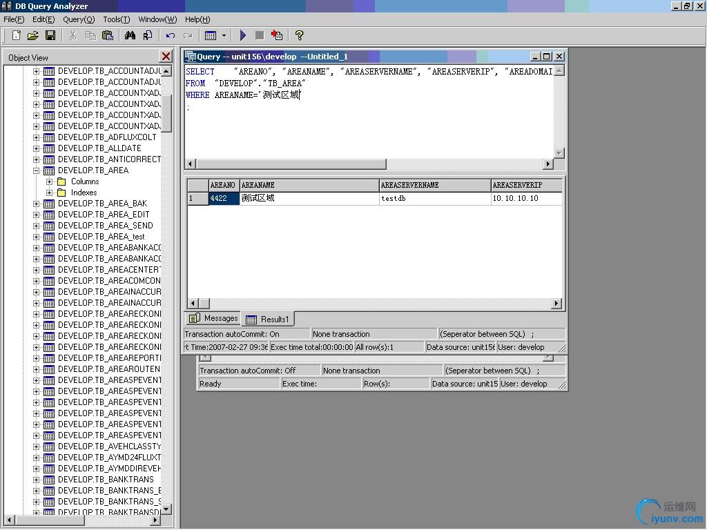

  在此,我们点击否,取消刚才的修改操作。在窗口1执行查询,发现表TB_AREA中“测试区域”的AREASERVERIP值还是“10.10.10.10”,如图7所示
  <wbr><a href="http://photo.blog.sina.com.cn/showpic.html#blogid=4b70463f0100st8n&amp;url=http://s11.sinaimg.cn/orignal/4b70463fga96b84b876fa" target="_blank"></a><br> DSC0006.gif <br></wbr>
  <wbr><wbr><wbr><wbr><wbr><wbr><wbr><wbr><wbr><wbr><wbr><wbr><wbr><wbr><wbr><wbr><wbr><wbr><wbr><wbr><wbr><wbr><wbr><span style="font-size:13px">图7<wbr><wbr> 回滚事务后进行的查询</wbr></wbr></span></wbr></wbr></wbr></wbr></wbr></wbr></wbr></wbr></wbr></wbr></wbr></wbr></wbr></wbr></wbr></wbr></wbr></wbr></wbr></wbr></wbr></wbr></wbr>
