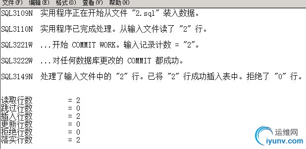

db2 import from t_user.sql of del modified by codepage=1386 insert into t_user(corpid,userid)>>log.txt   //这个定义参照db2set -all设置,可以保证插入数据全部显示
  db2 commit
  db2 terminate
pause
exit
  start.bat内容如下
  @echo off
db2cmd init.bat
exit
  编辑的每一个语句以@结束,insert以最后一条记录为准后@结束
  用到这句话时,t_user.sql用记事本打开
  "武金晶","010184","901010200",5,"120108198502280023","13662003683","965EB72C92A549DD","01"
"强雅薇","012111","901010200",5,"120106199107267023","13802098032","965EB72C92A549DD","01"
  无需加@,执行结果在log日志中显示
