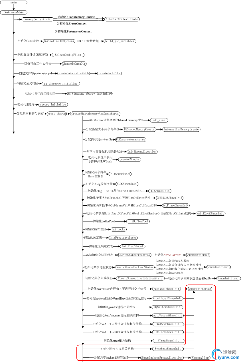

1先上个图,看一下函数调用过程梗概,中间略过部分细节
初始化同步扫描和Backend结构数组方法调用流程图
2初始化同步扫描相关结构

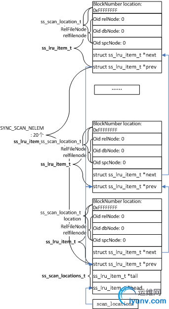

话说main()->…->PostmasterMain()->…->reset_shared() ->CreateSharedMemoryAndSemaphores()>…->SyncScanShmemInit(),调用ShmemInitStruct(),在其中调用hash_search()在哈希表索引"ShmemIndex"中查找"Sync Scan Locations List",如果没有,就在shmemIndex中给"Sync Scan Locations List"分一个HashElement和ShmemIndexEntentry),在其中的Entry中写上"Sync Scan Locations List"。返回ShmemInitStruct(),再调用ShmemAlloc()在共享内存上给"Sync Scan Locations List"相关结构(见下面“Sync Scan Locations List相关结构图”)分配空间,设置entry(在这儿及ShmemIndexEnt类型变量)的成员location指向该空间,size成员记录该空间大小,最后返回SyncScanShmemInit(),让ss_scan_locations_t*类型静态全局变量scan_locations指向所分配内存,初始化ss_scan_locations_t结构类型的成员值。

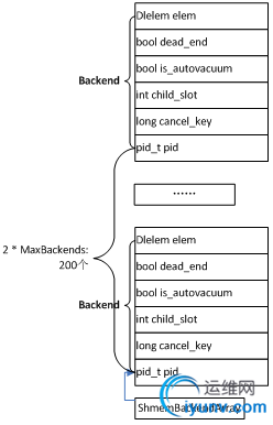

接着main()->…->PostmasterMain()->…->reset_shared() ->CreateSharedMemoryAndSemaphores() ->…-> ShmemBackendArrayAllocation(),调用ShmemAlloc()在共享内存上分配2 *MaxBackendsBackend结构数组见下面“Backend结构数组图”),让Backend *类型静态全局变量ShmemBackendArray指向所分配内存,用memset把所分配内存置0。

typedef struct ss_scan_location_t
    RelFileNode relfilenode; /* identity of a relation */
    BlockNumber location;       /* last-reported location in the relation */
} ss_scan_location_t;
typedef struct ss_lru_item_t
    struct ss_lru_item_t *prev;
    struct ss_lru_item_t *next;
    ss_scan_location_t location;
} ss_lru_item_t;
typedef struct ss_scan_locations_t
    ss_lru_item_t *head;
    ss_lru_item_t *tail;
    ss_lru_item_t items[1];     /* SYNC_SCAN_NELEM items */
} ss_scan_locations_t;
#define SizeOfScanLocations(N)offsetof(ss_scan_locations_t, items[N])
/* Pointer to structin shared memory */
static ss_scan_locations_t *scan_locations;

typedef struct bkend
    pid_t      pid;          /* process id of backend */
    long       cancel_key;       /* cancelkey for cancels for this backend */
    int        child_slot;       /*PMChildSlot for this backend, if any */
    bool       is_autovacuum;    /* is itan autovacuum process? */
    bool       dead_end;     /* is itgoing to send an error and quit? */
    Dlelem     elem;         /* list link in BackendList */
} Backend;
static Backend *ShmemBackendArray;

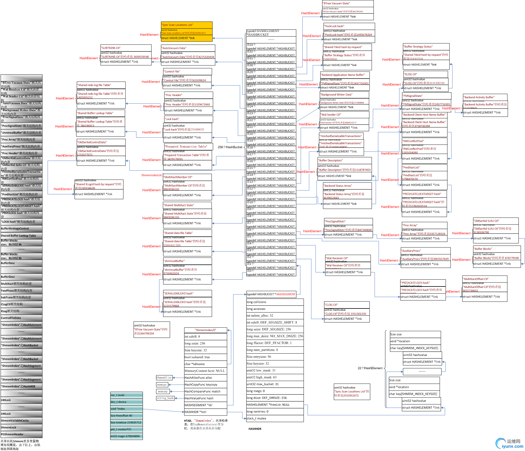

 初始化完Sync Scan Locations List相关结构的共享内存结构图
       为了精简上图,把创建shmem的哈希表索引"ShmemIndex"时创建的HCTL结构删掉了,这个结构的作用是记录创建可扩展哈希表的相关信息,不过这个结构在"ShmemIndex"创建完成后也会由于出了对象作用域而消失。增加了左边灰色底的部分,描述共享内存/shmem里各变量物理布局概览,由下往上,由低地址到高地址。图中黄色的索引项就是本节新增加的索引项。
Backend结构数组图
