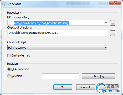

Checkout of the branch test ZeosLib ( svn: / / zeos.firmos.at / zeos /branches / testing ) to a directory.
If your client is svn command line, open the command prompt and move to thedirectory where you want to checkout and run the command: svn checkoutsvn: / / zeos.firmos.at / zeos / branches / testing.
If you have installed Tortoise SVN client or any other, the procedure is eveneasier.
In this article the directory D: \ Delphi \ Components \ ZeosDBO2011 \ willbe the venue for the checkout is used as a base path. So, if you choose adifferent path, just adjust the settings in step-by-step installation for thisnew path.

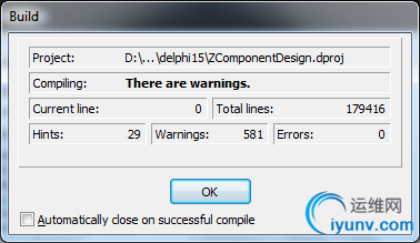

3. Build all projects (Project menu -> BuildAll Projects);
If everything is ok, Delphi will report the occurrence of many hints andwarnings during the build of packages. Do not worry, for now we assumethat these reports do not present problems.
However you will most likely have an error message stating that they did notfind a particular file name (Example: "... [DCC Fatal Error]ZCore.dpk (51): F1026 File not found: 'ZVariant.dcu' .. .. ")

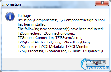

4. Install the package of components by selecting the "Install" (fromthe context menu) package "ZComponentDesign150.bpl";

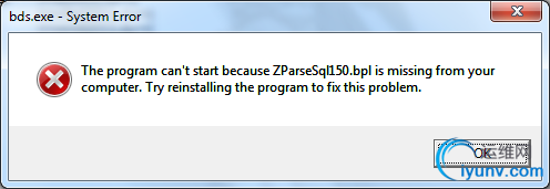

If you try to installthe package "ZComponentDesign150.bpl" is displayedan error message like the image below, it means that Delphi did not find thefile. GLP specific.

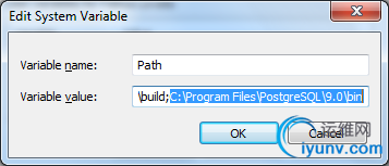

The most practical and quick to fix this problem is to enter the directorywhere this. BPL is located in the PATH system.
Note that when builder packages ZeosLib will be created a directory located inthe subdirectory called build. "\ Packages \ delphi15."
So, just add this path (D: \ Delphi \ Components \ ZeosDBO2011 \ packages \delphi15 \ build) in the directory listing of the environment variable "PATH".
NOTE: Any changes in the environment variables will require close and reopenthe Delphi for the changes to take effect.
If you try to install the package "ZComponentDesign150.bpl" isdisplayed an error message same as or similar to the image below, was probablyan oversight in the specification of the path ZeosDBO.
Classify as careless because this error was caused when he was trying toinstall ZeosDBO who was in a path different from that referenced in the SystemPath and Library Path (in the Delphi IDE).
So, be sure to indicate exactly all the path to the directory where the ZeosDBis located.
If all goes well Delphi will present a dialog informing the list of componentsthat were installed.

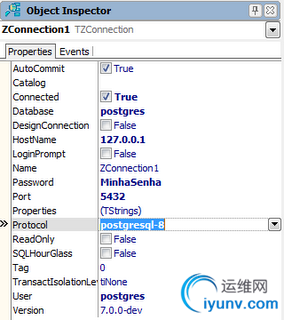

For this basic test, anew project was created and a componentTZConnection was dropped onthe form.
Note on the image thatthe connection was made successfully on the database itself postgres(metadata).
A point to note is thatthe list of protocols (protocol property) there is an item "postgresql-9" asexpected. Thus, the most likely option was to use "postgresql-8."
I think the time isadded with an exclusive option for postgresql version 9, since this introducessignificant changes.
The component configuration TZConnection the DFM is presented as:
ZConnection1 object: TZConnection
Properties.Strings = (
'Codepage = UTF8'
'Client_encoding = UTF8')
AutoCommit = False
Connected = True
Protocol = 'postgresql-8'
HostName = '127 .0.0.1 '
Port = 5432
Database = 'postgres'
User = 'postgres'
Password = 'mypassword'
Left = 126
Top = 16
end

This is a classicproblem that is solved or by copying the necessary files to the project folderor by adding the directory where those files are located in the PATH system.
All DLLs are located inthe subdirectory "bin" of the PostgreSQLinstallation directory (probably C: \ Program Files \ PostgreSQL \ 9.0\ bin).
As shown in the picture above, the chosen solution was to add the PostgreSQLinstallation directory to the PATH system that is not necessary to have torecopy the DLLs for new projects that use the ZeosDBO.
After this was only necessary to close and reopen the Delphi and the connectionwas as expected.
