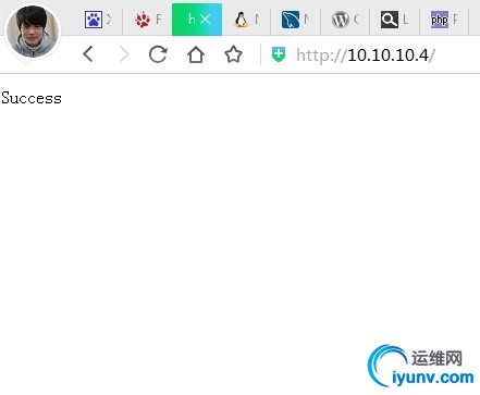

6)启动apache并测试
[iyunv@WebServer ~]# /etc/init.d/httpd restart    # 重启
Stopping httpd:                                            [  OK  ]
Starting httpd:
使用浏览器访问:

8、PHP连接Mysql测试
编辑apache的默认页面/usr/local/apache/htdocs/index.php
[iyunv@WebServer ~]# vim /usr/local/apache/htdocs/index.php
        $conn=mysql_connect('localhost','root','');
        if ($conn)
                echo "Success";
        else
                echo "Failure";
测试页面,连接mysql成功
