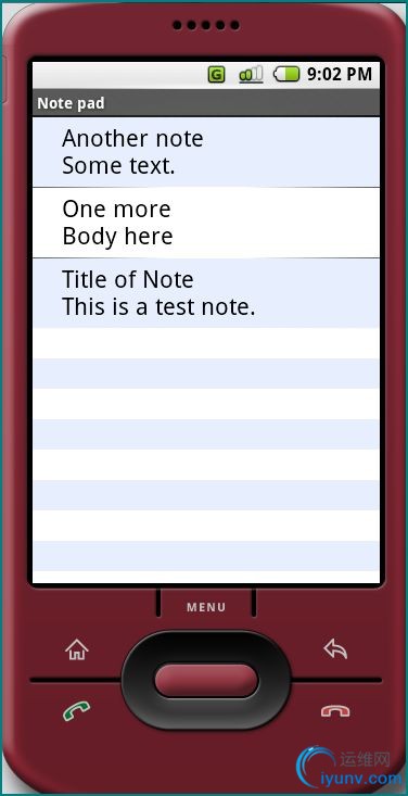

  You can issue queries like ‘select * from notes’ to get the data from the notes table. As you can see from the figure below, I have entered a series of notes in the notepad application.
Figure 1. Notes in the Note pad application
DSC0000.jpg   After entering the notes, if you query the notes table, you will get the data in the _id, title, note, created, and modified columns.

sqlite> select * from notes;
1|Title of Note
This is a test note.|This is a test note.|1205871448827|1205873944838
3|Another note
Some text.|A third note
Some text.|1205873990394|1205874145996
4|One more
Body here|One more
Body here|1205874074992|1205874088072
