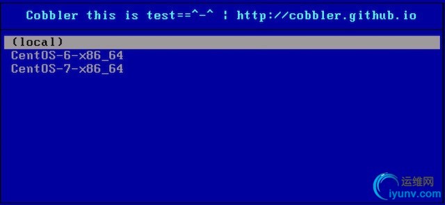

导入一个cs7镜像:
# mount /dev/cdrom  /mnt/
# cobbler import --path=/mnt/ --name=CentOS-7-x86_64 --arch=x86_64
导入一个cs6镜像:
导入前需要先卸载镜像,然后装载新的镜像,
# umount  /mnt/
# cobbler import --path=/mnt/ --name=CentOS-6-x86_64 --arch=x86_64

[iyunv@cobbler1 /]# cobbler profile
usage
cobbler profile add
cobbler profile copy
cobbler profile dumpvars
cobbler profile edit
cobbler profile find
cobbler profile getks
cobbler profile list
cobbler profile remove
cobbler profile rename
cobbler profile report
[iyunv@cobbler1 /]# cobbler profile list
   CentOS-6-x86_64
   CentOS-7-x86_64

修改cobbler的启动安装界面
Cobbler的启动安装界面可以有自定义的提示,通修改pxe的模板文件来实现:
9
10
11
12
13
[iyunv@cobbler1 ~]# cat /etc/cobbler/pxe/pxedefault.template
DEFAULT menu
PROMPT 0
MENU TITLE Cobbler this is test==^-^ |   #提示栏信息
TIMEOUT 200
TOTALTIMEOUT 6000
ONTIMEOUT $pxe_timeout_profile
LABEL local                         #默认的启动列表
        MENU LABEL (local)
        MENU DEFAULT
        LOCALBOOT -1
$pxe_menu_items
MENU end
执行sync 使命令生效:
# cobbler sync
在新建的设备启动界面为:
