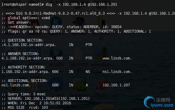

增加一个反向解析域:
    vi /etc/named.conf
9
10
11
12
13
14
15
16
options {
    directory "/var/named";
    listen-on {192.168.1.201;};
zone "." IN {
    type hint;
    file "named.ca";
zone "linzb.com" IN {
    type master;
    file "linzb.com.zone";
zone "1.168.192.in-addr.arpa" IN {
    type master;
    file "192.168.1.zone";
编辑反向区域文件:
    vi /var/named/192.168.1.zone
9
10
$TTL 600
@   IN  SOA ns1.linzb.com. admin.linzb.com (
                        1H
                       2W
                       3D
                       600 )
    IN  NS  ns1.linzb.com.
201 IN  PTR ns1.linzb.com.
4   IN  PTR www.linzb.com.
    反向区域文件的ip顺序是倒过来写的加上in-addr.arpa. 结尾,剩下的就是把正向区域文件的name和value的值反过来写。
    named-checkconf
    named-checkzone 1.168.192.in-addr.arpa /var/named/192.168.1.zone
    /etc/init.d/named restart
测试:
dns的主从配置:
