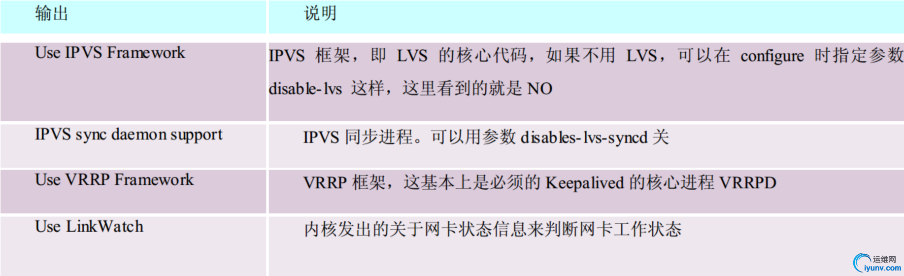

Keepalived的安装与相关配置文件详解
1:安装ipvsadm软件:
[iyunv@xuegod63~]# rpm -ivh /mnt/Packages/ipvsadm-1.25-9.el6.x86_64.rpm
安装keepalived
[iyunv@xuegod63 ~]# tar zxvf keepalived-1.2.16.tar.gz
[iyunv@xuegod63 ~]# cd keepalived-1.2.16

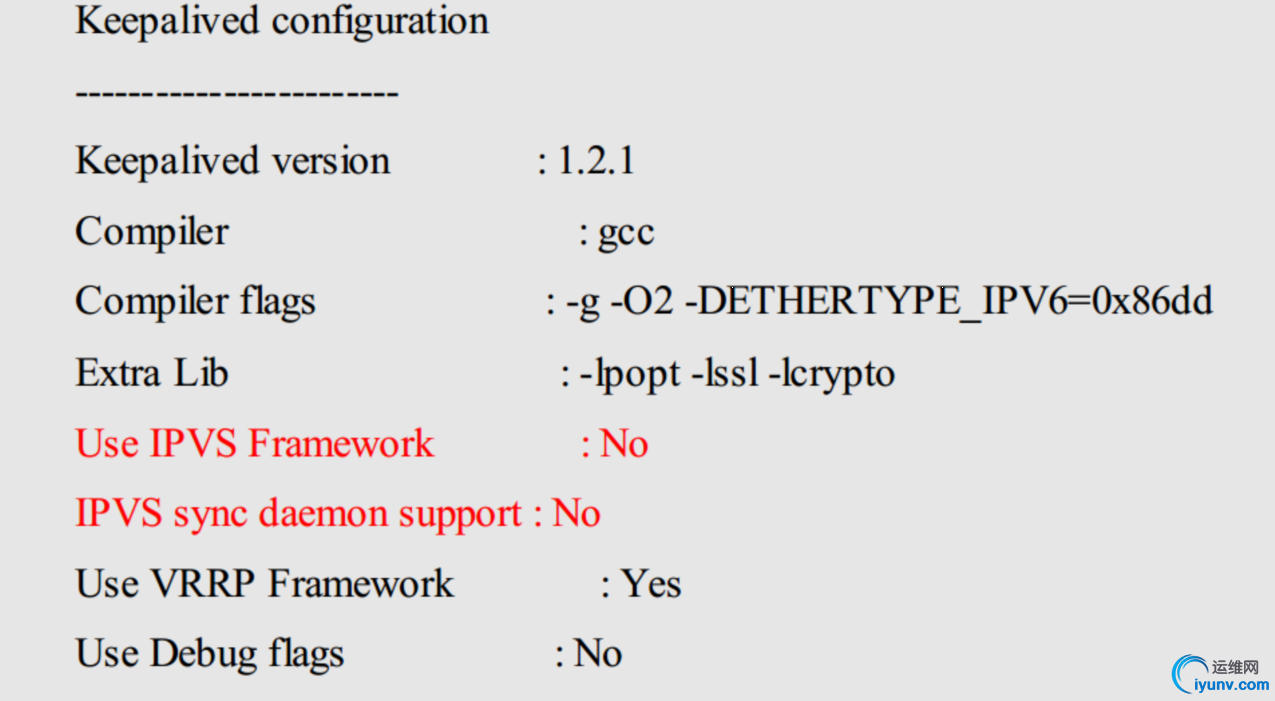

[iyunv@xuegod61 keepalived-1.1.17]# ./configure --prefix=/usr/local/keepalived
[iyunv@xuegod63 keepalived-1.2.16]# make -j 4 && make inatsll
[iyunv@xuegod63 ~]# /etc/init.d/keepalived start
[iyunv@xuegod63 ~]# chkconfig keepalived on
扩展:

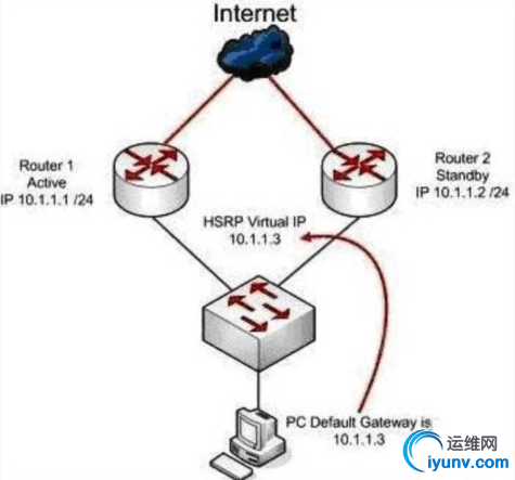

虚拟路由冗余协议(Virtual Router Redundancy Protocol,简称VRRP)是由IETF提出的解决局域网中配置静态网关出现单点失效现象的路由协议。使用组播方式通信。
VRRP是一种路由容错协议,也可以叫做备份路由协议。一个局域网络内的所有主机都设置缺省路由(默认网关),当网内主机发出的目的地址不在本网段时,报文将被通过缺省路由发往外部路由器,从而实现了主机与外部网络的通信。当缺省路由器down掉(即端口关闭)之后,内部主机将无法与外部通信,如果路由器设置了VRRP时,那么这时,虚拟路由将启用备份路由器,从而实现全网通信。
工作流程如图:

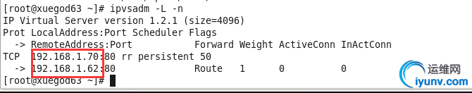

[iyunv@xuegod63 etc]# service keepalived restart
[iyunv@xuegod63 etc]# ipvsadm -L -n
IP Virtual Server version 1.2.1 (size=4096)
Prot LocalAddress:Port Scheduler Flags
-> RemoteAddress:Port           Forward Weight ActiveConn InActConn
TCP 192.168.1.70:80 rr persistent 50
注:没有看到realserver,是因为两台realserver没有开启httpd服务。

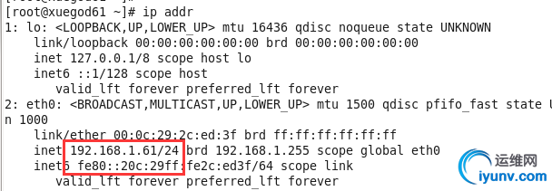

测试备用节点
[iyunv@xuegod63 ~]# service keepalived stop
查看日志
[iyunv@xuegod61 rc.d]# tail -f /var/log/messages
Dec  6 02:34:29 xuegod61 Keepalived_vrrp[5290]: VRRP_Instance(apache{) Entering MASTER STATE
Dec  6 02:34:29 xuegod61 Keepalived_vrrp[5290]: VRRP_Instance(apache{) setting protocol VIPs.
Dec  6 02:34:29 xuegod61 Keepalived_healthcheckers[5289]: Netlink reflector reports IP 192.168.1.70 added
Dec  6 02:34:29 xuegod61 Keepalived_vrrp[5290]: VRRP_Instance(apache{) Sending gratuitous ARPs on eth0 for 192.168.1.70

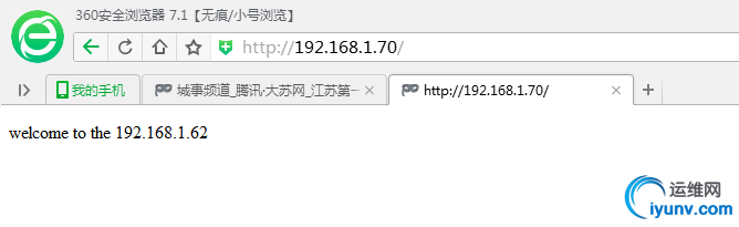

[iyunv@xuegod62 ~]# echo '192.168.1.62' > /var/www/html/index.html
[iyunv@xuegod62 ~]# service httpd restart

4:测试---负载均衡
测试----VIP 192.168.1.70
注:这里同一IP地址50S以内,都分配到同一台realserver,等待50秒。

[iyunv@xuegod63 keepalived]# /etc/init.d/keepalived start
[iyunv@xuegod63 keepalived]# ip addr
inet 192.168.1.63/24 brd 192.168.1.255 scope global eth0
inet 192.168.1.70/32 scope global eth0
inet6 fe80::20c:29ff:fe12:ec1e/64 scope link
valid_lft forever preferred_lft forever
[iyunv@ xuegod61~]# ip addr #没有VIP了。
link/ether 00:0c:29:c5:08:33 brd ff:ff:ff:ff:ff:ff
测试RS容错
首先查看下lvs 配置ipvsadm -ln  可以看到所有RS 服务器地址
[iyunv@xuegod63 ~]# ipvsadm -L -n
-> 192.168.1.62:80              Route   1      0          30
-> 192.168.1.64:80              Route   1      0          2

[iyunv@xuegod61 keepalived-1.2.16]# ./configure
解决办法:由提示可以看到,没有发现gcc cc 编译工具,只需要安装即可。解决方法:
[iyunv@xuegod61 keepalived-1.2.16]#yum install gcc gcc-C++

Configure 最后输出说明
