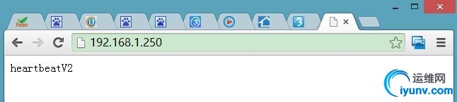

[iyunv@master ~]# curl 192.168.1.250
heartbeatV2
关闭node2验证是否能够访问验证高可用性
[iyunv@node2 ~]# service heartbeat stop
Stopping High-Availability services:
Done.
