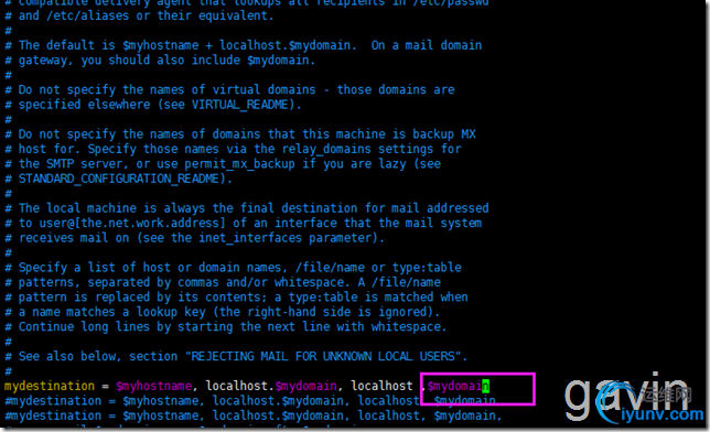

我们需要在mydestination的值后面添加 $mydomain ,如果不添加的话,收件人的地址会有问题,如果添加后,用户发送邮件直接会是
xx@domain.com

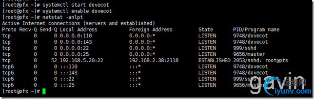

然后启动服务
systemctl start dovecot
systemctl enable dovecot
我们看见110、143都已经监听了

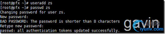

接下来我们创建一个测试用户
useradd zs
passwd zs
然后输入新旧密码

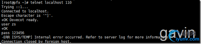

9
10
[iyunv@pfx ~]# telnet localhost 110
Trying ::1...
Connected to localhost.
Escape character is '^]'.
+OK Dovecot ready.
user zs
+OK
pass 123456
-ERR [SYS/TEMP] Internal error occurred. Refer to server log for more information.
Connection closed by foreign host.

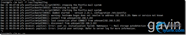

我们查看log
9
10
11
[iyunv@pfx ~]# tail -f /var/log/maillog
Dec 21 00:37:58 pfx postfix/postfix-script[9570]: stopping the Postfix mail system
Dec 21 00:37:58 pfx postfix/master[9553]: terminating on signal 15
Dec 21 00:38:01 pfx postfix/postfix-script[9654]: starting the Postfix mail system
Dec 21 00:38:01 pfx postfix/master[9656]: daemon started -- version 2.10.1, configuration /etc/postfix
Dec 21 00:38:08 pfx postfix/smtpd[9661]: warning: hostname bogon does not resolve to address 192.168.5.20: Name or service not known
Dec 21 00:38:08 pfx postfix/smtpd[9661]: connect from unknown[192.168.5.20]
Dec 21 00:38:20 pfx postfix/smtpd[9661]: lost connection after CONNECT from unknown[192.168.5.20]
Dec 21 00:38:20 pfx postfix/smtpd[9661]: disconnect from unknown[192.168.5.20]
Dec 21 00:55:46 pfx dovecot: pop3(zs): Error: user zs: Initialization failed: Namespace '': Mail storage autodetection failed with home=/home/zs
Dec 21 00:55:46 pfx dovecot: pop3(zs): Error: Invalid user settings. Refer to server log for more information.
我们切换到刚才的用户
su – zs
然后为用户zs,创建inbox目录
mkdir -p ~/mail/.imap/INBOX
然后再次尝试就可以了

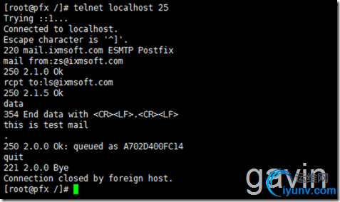

测试发送邮件
9
10
11
12
13
14
15
16
17
[iyunv@pfx /]# telnet localhost 25
Trying ::1...
220 mail.ixmsoft.com ESMTP Postfix
mail from:zs@ixmsoft.com
250 2.1.0 Ok
rcpt to:ls@ixmsoft.com
250 2.1.5 Ok
data
354 End data with <CR><LF>.<CR><LF>
this is test mail
250 2.0.0 Ok: queued as A702D400FC14
quit
221 2.0.0 Bye

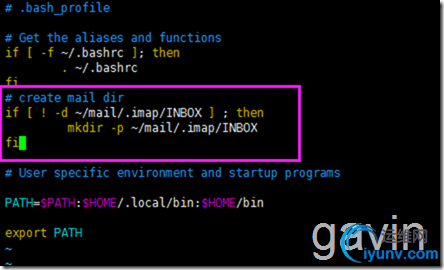

修改创建用户模板文件,使用户创建时自动生成mail存放目录
vim /etc/skel/.bash_profile   添加一下配置文件,
if[ ! -d ~/mail/.imap/INBOX ] ; then
fi
注:如果是复制的,最好在保存推出前,执行以下编码格式的执行
:set format=unix
或者可以下载附件,替换当前的配置文件即可
保存退出后,执行一下,为其快速生效。
source .bash_profile
