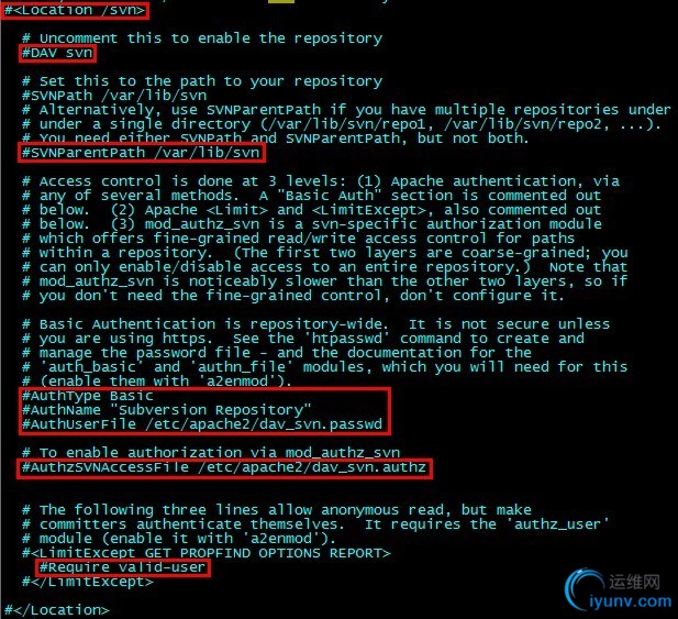

接下来,我们需要修改/etc/apache2/mods-available/dav_svn.conf文件,配置SVN版本库:
sudo vi /etc/apache2/mods-available/dav_svn.conf
打开红框中的注释,
# dav_svn.conf - Example Subversion/Apache configuration
# For details and further options see the Apache user manual and
# the Subversion book.
# NOTE: for a setup with multiple vhosts, you will want to do this
# configuration in /etc/apache2/sites-available/*, not here.
# <Location URL> ... </Location>
# URL controls how the repository appears to the outside world.
# In this example clients access the repository as http://hostname/svn/
# Note, a literal /svn should NOT exist in your document root.
<Location /svn>
# Uncomment this to enable the repository
DAV svn
# Set this to the path to your repository
#SVNPath /var/lib/svn
# Alternatively, use SVNParentPath if you have multiple repositories under
# under a single directory (/var/lib/svn/repo1, /var/lib/svn/repo2, ...).
# You need either SVNPath and SVNParentPath, but not both.
SVNParentPath /var/lib/svn
# Access control is done at 3 levels: (1) Apache authentication, via
# any of several methods.  A "Basic Auth" section is commented out
# below.  (2) Apache <Limit> and <LimitExcept>, also commented out
# below.  (3) mod_authz_svn is a svn-specific authorization module
# which offers fine-grained read/write access control for paths
# within a repository.  (The first two layers are coarse-grained; you
# can only enable/disable access to an entire repository.)  Note that
# mod_authz_svn is noticeably slower than the other two layers, so if
# you don't need the fine-grained control, don't configure it.
# Basic Authentication is repository-wide.  It is not secure unless
# you are using https.  See the 'htpasswd' command to create and
# manage the password file - and the documentation for the
# 'auth_basic' and 'authn_file' modules, which you will need for this
# (enable them with 'a2enmod').
AuthType Basic
AuthName "Subversion Repository"
AuthUserFile /etc/apache2/dav_svn.passwd
# To enable authorization via mod_authz_svn
AuthzSVNAccessFile /etc/apache2/dav_svn.authz
# The following three lines allow anonymous read, but make
# committers authenticate themselves.  It requires the 'authz_user'
# module (enable it with 'a2enmod').
#<LimitExcept GET PROPFIND OPTIONS REPORT>
Require valid-user
#</LimitExcept>
</Location>
分述:
<Location /svn></Location>成对儿出现!
DAV svn开启DAV模块支持!
SVNPath /var/lib/svnSVNParentPath /var/lib/svn选其一,不可同时出现!建议使用SVNParentPath,可以在SVN根目录下创建多个SVN版本库!
引用
  AuthType Basic
定义了授权类型、并指定了密码文件(/etc/apache2/dav_svn.passwd)。
AuthzSVNAccessFile /etc/apache2/dav_svn.authz授权配置文件,规定了路径访问权限!
引用
   Require valid-user
#</LimitExcept>
建议只使用Require valid-user,打开<LimitExcept />注释,将允许匿名访问!

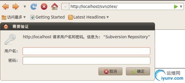

然后访问http://localhost/svn/zlex:
试试检出:

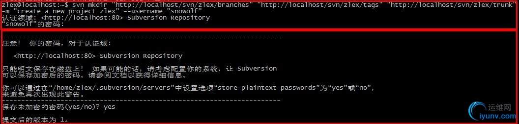

我们之前构建了一个项目仓库——zlex,现在项目有了,我们需要构建相应的版本库管理,及trunk、tags以及branches!
用命令创建:
svn mkdir "http://localhost/svn/zlex/branches" "http://localhost/svn/zlex/tags" "http://localhost/svn/zlex/trunk" -m "create a new project zlex" --username "snowolf"
这时,我们用zlex账号提交一个docs目录:
svn mkdir "http://192.168.49.132/svn/zlex/docs" -m "文档目录" --username zlex
系统会提示输入密码:
192.168.49.132是我本机的IP地址!

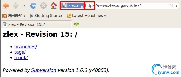

如果你参照征服 Apache + SSL完成了HTTPS平台搭建,这时候,也可以使用HTTPS方式访问了:
