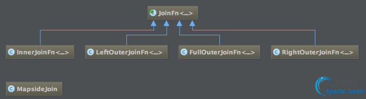

It's no need for you to instanciate each type of join class yourself, Crunch has a utility class for joining multiple PTable instances based on a common key. With these built-in support for Map-side and Reduce-side joins, you can write semi-joins as well. Now let's talk about the built-in supportted joins one by one.
  • Join utility class
    From the class outline you can see each type of join is exposed by a static method, the only exception is the MapsideJoin, which we will talk about later. Another thing you should note is there is a method called preJoin(...), which is used to launch a number of Map tasks to tag the data to be joined. After that, the method groupByKey(...) will be called which result in a reduce phase been triggered.
