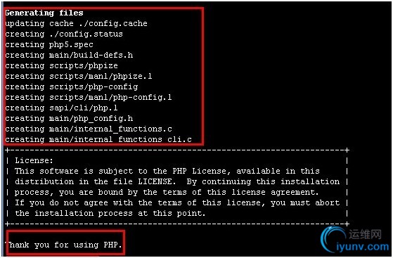

  如果编译成功的话应该显示如下结束信息:
  Generatingfiles
  updatingcache ./config.cache
  creating./config.status
  creatingphp5.spec
  creatingmain/build-defs.h
  creatingscripts/phpize
  creatingscripts/man1/phpize.1
  creatingscripts/php-config
  creatingscripts/man1/php-config.1
  creatingsapi/cli/php.1
  creatingmain/php_config.h
  creatingmain/internal_functions.c
  creatingmain/internal_functions_cli.c
  |License:|
  |This software is subject to the PHP License, available in this |
  |distribution in the file LICENSE. Bycontinuing this installation |
  |process, you are bound by the terms of this license agreement. |
  |If you do not agree with the terms of this license, you must abort |
  |the installation process at this point. |
  Thankyou for using PHP.
  截图如下:

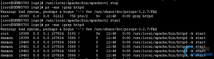

  1) 查看apache进程是否启动
  2) 查看apache日志(进程号)

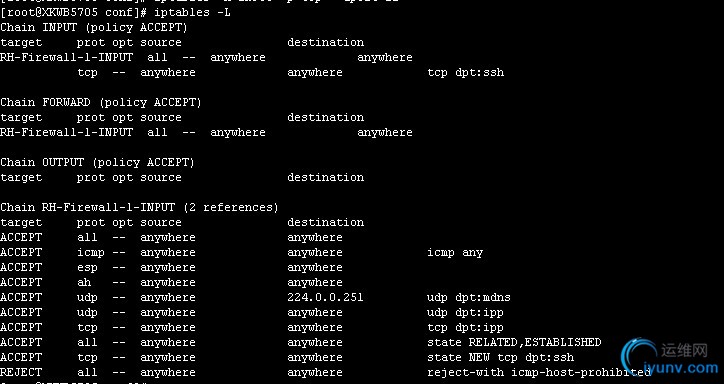

  7) 看看防火墙iptables有没有限制
  从以上截图可以看到防火墙是没有限制的
  准备工作做好了,可是通过访问IP还是无法访问
  这是怎么回事呢
  最后停掉iptables
  再次访问 http://211.100.97.250/ 成功
  什么原因呢?
