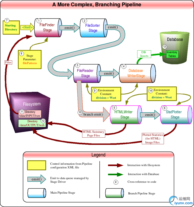

例三:
  带颜色的配置文件如下:
Document   : branchingPipeline.xml
Description: Configuration file for a pipeline that takes
user provided files as input, and from that both generates HTML files and
puts data into a database.
<pipeline>
<driverFactory className="org.apache.commons.pipeline.driver.DedicatedThreadStageDriverFactory"
id="df0"/>
id="df1">
<property propName="queueFactory"
className="org.apache.commons.pipeline.util.BlockingQueueFactory$ArrayBlockingQueueFactory"
capacity="4" fair="false"/>
</driverFactory>
The <env> element can be used to add global environment variable values to the pipeline.
In this instance almost all of the stages need a key to tell them what type of data
to process.
<env>
<value key="division">West</value> <!-- ((9)) -->
</env>
((1)) The initial stage traverses a directory so that it can feed the filenames of
of the files to be processed to the subsequent stages.
The directory path to be traversed is in the feed block at the end of this file.
The filePattern in the stage block is the pattern to look for within that directory.
<stage className="org.apache.commons.pipeline.stage.FileFinderStage"
driverFactoryId="df0"
filePattern="SALES\.(ASWK|ST(GD|GL|LD))\.N.?\.D\d{5}"/><!-- ((8)) --><feed>
<value>/data/INPUT/raw</value> <!-- ((7)), ((11)) -->
</feed>
((2)) This stage is going to select a subset of the files from the previous stage
and orders them for time sequential processing using the date embedded in
the last several characters of the file name.
The filesToProcess is the number of files to emit to the next stage, before
terminating processing.  Zero (0) has the special meaning that ALL available
files should be processed.
<stage className="com.demo.pipeline.stages.FileSorterStage"
driverFactoryId="df1"
filesToProcess="0"/>
((3)) Read the files and create the objects to be passed to stage that writes to
the database and to the stage that writes the data to
HTML files.
WARNING:  The value for htmlPipelineKey in the stage declaration here
must exactly match the branch pipeline key further down in this file.
<stage className="com.demo.pipeline.stages.FileReaderStage"
htmlPipelineKey="sales2html"/>
((4)) Write the data from the FileReaderStage stage into the database.
<stage className="com.demo.pipeline.stages.DatabaseWriterStage"
driverFactoryId="df1">
<datasource user="test"
password="abc123"
type="oracle"
host="brain.demo.com"
port="1521"
database="SALES" />
<database-proxy className="gov.noaa.gdsg.sql.oracle.OracleDatabaseProxy" />
<tablePath path="summary.inventory" /> <!-- ((13)) -->
</stage>
Write the data from the FileReaderStage stage to HTML files.
The outputFilePath is the path to which we will be writing our summary HTML files.
WARNING:  The value for the branch pipeline key declaration here must
exactly match the htmlPipelineKey in the FileReaderStage stage in this file.
<branch>
<pipeline key="sales2html"> <!-- ((10)) --><env>
<value key="division">West</value> <!-- ((14)) -->
</env>
id="df2">
</driverFactory>
<!-- ((5)) HTMLWriterStage -->
<stage className="com.demo.pipeline.stages.HTMLWriterStage"
driverFactoryId="df2"
outputFilePath="/data/OUTPUT/web"/> <!-- ((12)) -->
<!-- ((6)) StatPlotterStage -->
<stage className="com.demo.pipeline.stages.StatPlotterStage"
outputFilePath="/data/OUTPUT/web"/> <!-- ((12)) --></pipeline>
</branch>
</pipeline>
  注:在这个例子中配置为“West” 的常量“division”,定义在两个地方。在主pipeline和分支pipeline都是相同的值。这是因为分支不共享相同的环境常数。
    该driverFactories“DF1”和“DF2”通过指定ArrayBlockingQueueFactory覆盖默认queueFactory。设置容量为4个对象,这样做是为了限制使用DF1或DF2的stage的队列大小。这通常是要限制pipeline使用的资源,并且是必要的,防止无界队列使用了所有可用的java存储或超过了所允许打开的文件句柄的数量。创建队列之后的队列大小不能被改变。因为只有一个线程正在访问的队列,公平属性可以被设置为“false”。如果公平=“true”,则有额外的开销,以确保访问队列中的所有线程的顺序处理(FIFO)。
