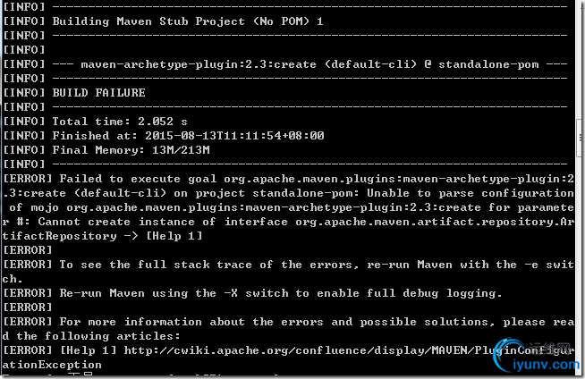

          在使用mvn 命令mvn archetype:create -DgroupId=com.chuanliu.c11 -DartifactId=c11searcher在控制创建maven项目和pom项目时,没有创建成功,错误信息如下:
 [ERROR] Failed to execute goal org.apache.maven.plugins:maven-archetype-plugin:2.4:create (default-cli)  on project standalone-pom: Unable to parse configuration of 3:  mojo org.apache.maven.plugins:maven-archetype-plugin:2.4:create for parameter #: Cannot create instance of interface org.apache.maven.artifact.repository.ArtifactRepository -> [Help 1]  [ERROR]  [ERROR] To see the full stack trace of the errors, re-run Maven with the -e switch. [ERROR] Re-run Maven using the -X switch to enable full debug logging. [ERROR] [ERROR] For more information about the errors and possible solutions, please read the following articles: [ERROR] [Help 1] http://cwiki.apache.org/confluence/display/MAVEN/PluginConfigurationException

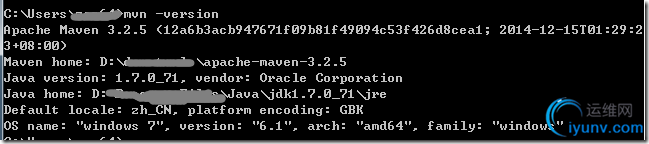

1、JAVA_HOME没有设置或者设置有误、m2_home设置有误
于是去查询mvn所依赖的版本和jdk版本,截图如下:
如果信息没问题,接着看后面的方案。

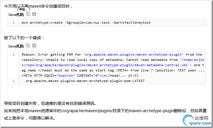

2、删除/org/apache/maven/plugins/下的maven-archetype-plugin
下图摘自网上:
按照图片上说的,删除了maven-archetype-plugin,重新执行命令,仍然报同样的错误,如下图所示:
于是继续使用后面的方案。
