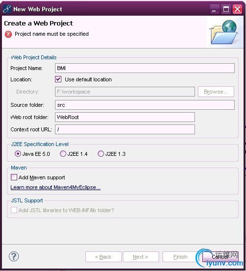

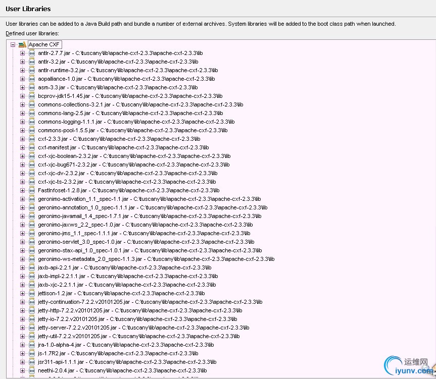

  3、After unzipping the archive, I added to WEB-INF/lib all the
libraries that are inside the apache-cxf-2.3.1\lib
  folder. It is of course
not a good habit to have since adding all sorts of libraries can produces
conflicts.
I had to remove a few jars such as :
jaxb-xjc-2.2.1.1.jar,
xalan-2.7.1.jar and serializer-2.7.1.jar
  There are probably a few extras jars that are not needed but at least they do
not produce any error for that simple web service.
