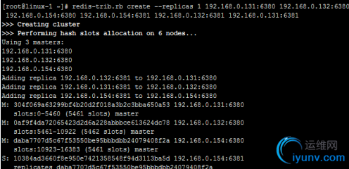

创建集群
/usr/local/redis-3.2.3/bin/redis-trib.rbcreate --replicas 1 192.168.0.131:6380 192.168.0.132:6380 192.168.0.154:6380192.168.0.154:6381 192.168.0.132:6381 192.168.0.131:6381
输入yes
