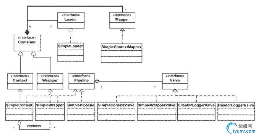

  The SimpleContext class represents a context. It uses the SimpleContextMapper as its mapper and SimpleContextValve as its basic valve. Two valves, ClientIPLoggerValve and HeaderLoggerValve, are added to the context. Two wrappers, each represented by SimpleWrapper, are added as child containers of the context. The wrappers use SimpleWrapperValve as their basic valve but do not have additional valves.
The Context application uses the same loader and the two valves. However, the loader and valves are associated with the context, not a wrapper. This way, the loader can be used by both wrappers. The context is assigned as the container for the connector. Therefore, the connector will call the invoke method of the context every time it receives an HTTP request. The rest is not hard to figure out if you recall our discussion above:
1. A container has a pipeline. The container's invoke method calls the pipeline's invoke method.
2. The pipeline's invoke method invokes all the valves added to its container and then calls its basic valve's invoke method.
3. In a wrapper, the basic valve is responsible to load the associated servlet class and respond to the request.
4. In a context with child containers, the basic valve uses a mapper to find a child container that is responsible for processing the request. If a child container is found, it calls the invoke method of the child container. It then goes back to Step 1.
Now let's see the order of processing in the implementation. The SimpleContext class's invoke method calls the pipeline's invoke method.
  public void invoke(Request request, Response response) throws IOException, ServletException {
   pipeline.invoke(request, response);
  The pipeline is represented by the SimplePipeline class. Its invoke method is as follows.
   public void invoke(Request request, Response response) throws IOException, ServletException { // Invoke the first Valve in this pipeline for this request
   (new SimplePipelineValveContext()).invokeNext(request, response);
