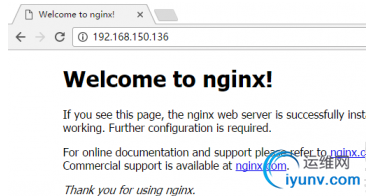

修改配置文件中servername从localhost修改为ip地址启动nginx测试
~]# /usr/local/nginx/sbin/nginx
~]# ss -tnlp | grep nginx
LISTEN     0      128                       *:80                       *:*      users:(("n ginx",3939,6),("nginx",3940,6))
