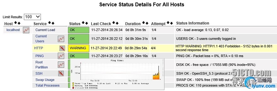

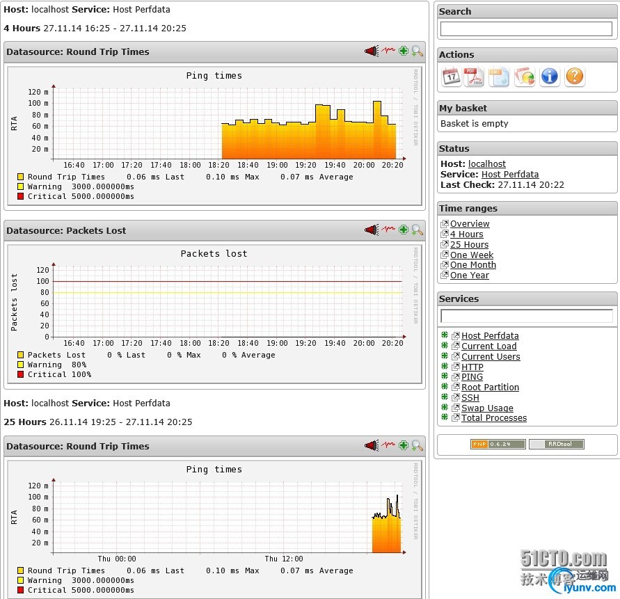

配置完成,将nagios重启
service nagios restart
到pnp4nagios-0.6.24解压目录下
cp pnp4nagios-0.6.24/contrib/ssi/status-header.ssi /usr/local/nagios/share/ssi/
9
10
11
12
13
vim /usr/local/nagios/etc/objects/templates.cfg
define host {
   name       host-pnp
   register   0
action_url /pnp4nagios/graph?host=$HOSTNAME$&srv=_HOST_' class='tips' rel='/pnp4nagios/popup?host=$HOSTNAME$&srv=_HOST_
   process_perf_data 1
define service {
   name       service-pnp
   register   0
action_url /pnp4nagios/graph?host=$HOSTNAME$&srv=$SERVICEDESC$' class='tips' rel='/pnp4nagios/popup?host=$HOSTNAME$&srv=$SERVICEDESC$
   process_perf_data 1
cd /usr/local/pnp4nagios/etc/pages
cp web_traffic.cfg-sample web_traffic.cfg
