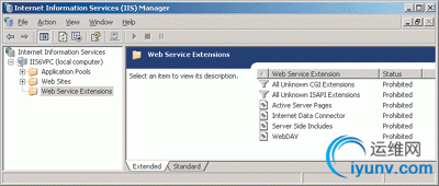

6. Make Good Use of Web Service Extensions in IIS 6.0
Web Service Extensions in IIS 6.0 is a mighty ally in the fight for security. This feature prevents executable content from being delivered unless it is explicitly allowed by full path name. By default, IIS 6.0 will not deliver any executable content! This means that if you want to allow ASP to run you must configure Web Service Extensions to permit ASP.dll to execute. As a result, even if you granted a Web site the NTFS permission of Everyone—Full Control, and an attacker placed an executable in the Web site, they still could not run the executable from a URL. A 404—File not Found error would be returned. Figure 3 shows the default configuration that allows only static content to be delivered.
Figure 3 IIS Manager
  This feature can be disabled by electing to allow "All Unknown ISAPI" and "All Unknown CGI". You may find yourself doing this when troubleshooting in order to remove potential problems. You will also find that developers who use IIS 6.0 will disable this feature as it can be quite annoying to have your most recent executables blocked every time you create a new one. This may be fine for your developers, but it is not fine on your production server.
