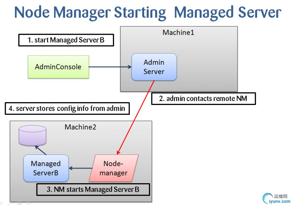

  • Make sure you understand that nodemanger will use default values to start your servers unless you specify them yourself in the admin console under server startup parameters.
  • Make sure you always start your servers with same startup parameters! This is really important. You end up in deep trouble if you don’t. Believe me.
    Imagine somebody is starting a managed server using the admin console and the provided values there. Next day somebody else starts a server using the provided scripts (which – at least in real life – will never be identical to the startup values configuredin the admin console). Now depending on the way the server was started it will behave differently and show erratic behaviour or not.

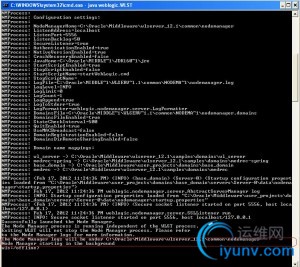

  iii) Start Node Managerusing command :
  startNodeManager(verbose=’true’, NodeManagerHome=’C:\\Oracle\\Middleware\\wlserver_12.1\\common\\nodemanager’, ListenPort=’5556′, ListenAddress=’localhost’)

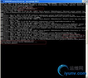

  v) Use the nmStart command to start a server.
nmStart(‘AdminServer’)
  Monitor the status of the Administration Server by entering the nmServerStatus command.
nmServerStatus(‘AdminServer’)

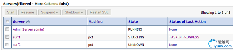

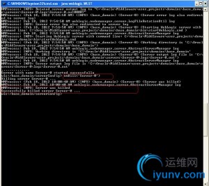

  vii) To start a Managed Server or cluster, enter the following command:
start(‘Server-0′,’Server’)
start(‘mycluster’, ‘Cluster’)

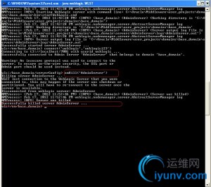

  viii) Stop the server by entering the nmKill command.
nmKill(‘Server-0‘)
  ix) Stop theAdminServer by entering the nmKill command.
nmKill(‘AdminServer‘)
  x) Disconnect the node manager :nmDisconnect()and Exit the WLST:exit()
