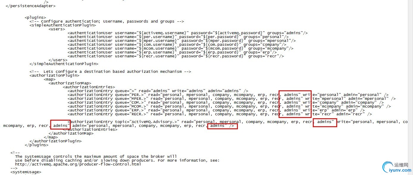

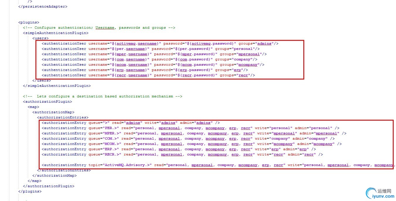

<plugins>
  <!-- Configure authentication; Username, passwords and groups -->
  <simpleAuthenticationPlugin>
  <users>
  <authenticationUser username="${activemq.username}" password="${activemq.password}" groups="admins"/>
  <authenticationUser username="${per.username}" password="${per.password}" groups="personal"/>
  <authenticationUser username="${mper.username}" password="${mper.password}" groups="mpersonal"/>
  <authenticationUser username="${com.username}" password="${com.password}" groups="company"/>
  <authenticationUser username="${mcom.username}" password="${mcom.password}" groups="mcompany"/>
  <authenticationUser username="${erp.username}" password="${erp.password}" groups="erp"/>
  <authenticationUser username="${recr.username}" password="${recr.password}" groups="recr"/>
  </users>
  </simpleAuthenticationPlugin>
  <!--  Lets configure a destination based authorization mechanism -->
  <authorizationPlugin>
<map>
  <authorizationMap>
<authorizationEntries>
  <authorizationEntry queue=">" read="admins" write="admins" admin="admins" />
  <authorizationEntry queue="PER.>" read="personal, mpersonal, company, mcompany, erp, recr" write="personal" admin="personal" />
  <authorizationEntry queue="MPER.>" read="personal, mpersonal, company, mcompany, erp, recr" write="mpersonal" admin="mpersonal" />
  <authorizationEntry queue="COM.>" read="personal, mpersonal, company, mcompany, erp, recr" write="company" admin="company" />
  <authorizationEntry queue="MCOM.>" read="personal, mpersonal, company, mcompany, erp, recr" write="mcompany" admin="mcompany" />
  <authorizationEntry queue="ERP.>" read="personal, mpersonal, company, mcompany, erp, recr" write="erp" admin="erp" />
  <authorizationEntry queue="RECR.>" read="personal, mpersonal, company, mcompany, erp, recr" write="recr" admin="recr" />
  <authorizationEntry topic="ActiveMQ.Advisory.>" read="personal, mpersonal, company, mcompany, erp, recr" write="personal, mpersonal, company, mcompany, erp, recr" admin="personal, mpersonal, company, mcompany, erp, recr" />

  以上配置今天发现队列监控出现异常,最后查到问题出现在这里:
  由于队列监控项目admin里使用的账户为system/manager(webapps\admin\WEB-INF\webconsole-embedded.xml
  ),属于admins群组,需要加上权限。
