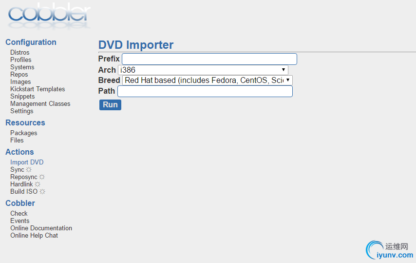

[iyunv@cobbler ~]# cobbler import --path=/mnt --name=CentOS-7.3 --arch=x86_64
task started: 2017-03-20_113200_import
task started (id=Media import, time=Mon Mar 20 11:32:00 2017)
Found a candidate signature: breed=redhat, version=rhel6
Found a candidate signature: breed=redhat, version=rhel7
Found a matching signature: breed=redhat, version=rhel7
Adding distros from path /var/www/cobbler/ks_mirror/CentOS-7.3-x86_64:
creating new distro: CentOS-7.3-x86_64
trying symlink: /var/www/cobbler/ks_mirror/CentOS-7.3-x86_64 -> /var/www/cobbler/links/CentOS-7.3-x86_64
creating new profile: CentOS-7.3-x86_64
associating repos
checking for rsync repo(s)
checking for rhn repo(s)
checking for yum repo(s)
starting descent into /var/www/cobbler/ks_mirror/CentOS-7.3-x86_64 for CentOS-7.3-x86_64
processing repo at : /var/www/cobbler/ks_mirror/CentOS-7.3-x86_64
need to process repo/comps: /var/www/cobbler/ks_mirror/CentOS-7.3-x86_64
looking for /var/www/cobbler/ks_mirror/CentOS-7.3-x86_64/repodata/*comps*.xml
Keeping repodata as-is :/var/www/cobbler/ks_mirror/CentOS-7.3-x86_64/repodata
*** TASK COMPLETE ***

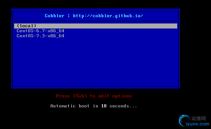

客户端设置从网卡启动:
安装完的CentOS6:

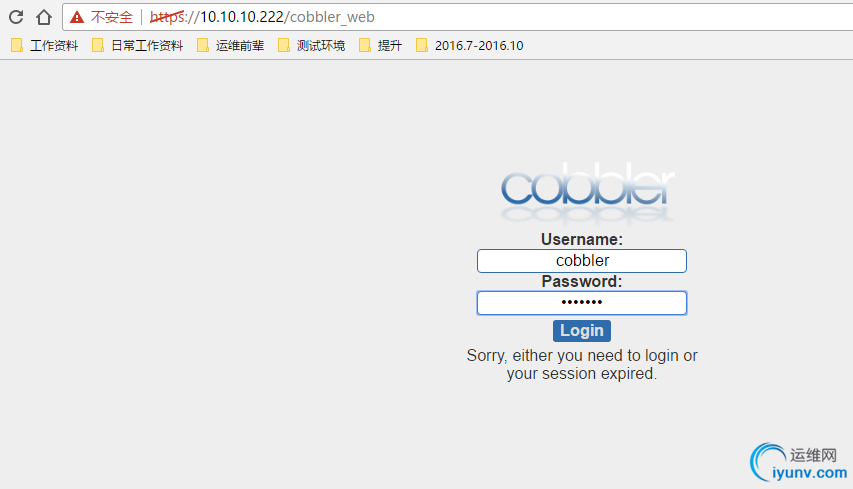

cobbler的图形化管理界面(默认用户名cobbler,默认密码cobbler):
