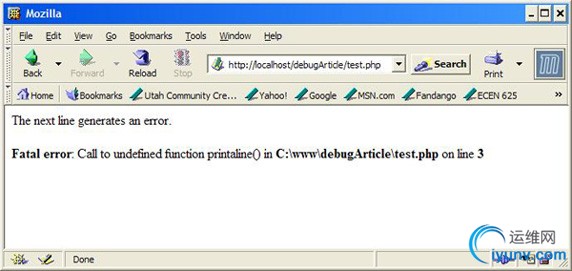

  You will save a great deal of time if you leave error reporting enabled. Errors in PHP point you right to the error in your code. Create a simple PHP file, test.php, and define it as shown in Listing 1.
Listing 1. A simple PHP that generates an error
  <?php  print("The next line generates an error.<br>");  printaline("PLEASE?");  print("This will not be displayed due to the above error.");  ?>
  The first print() statement should display its contents to the Web browser. However, the second statement generates and displays an error to the Web page. This results in the last print() statement do nothing, as shown in Figure 1.
Figure 1. Generating an error
  You have error reporting turned on! Next, we use print statements to help debug applications.

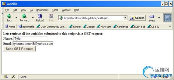

Listing 2. Display all variables submitted via GET
  <?php   $j = "";   print("Lets retrieve all the variables submitted to this ");   print("script via a GET request:<br>");   foreach($_GET as $key => $i){       print("$key=$j<br>");   }   if($_GET['Submit'] == "Send GET Request")       $j = "done!<br>";  ?>  <form method="GET">       Name: <input name="name"><br>       Email: <input name="email" size="25"><br>       <input name="Submit" type="submit" value="Send GET Request">  </form>
  You may be able to spot the bug in Listing 2 very easily. Good for you! Note that this is a simple script, and is shown as an example in using print statements to debug. The script simply takes all variables in the GET request, if any, and displays them back to the browser. A form is also supplied for you to send variables to the server using a GET request for testing. See the output, as shown in Figure 2.
Figure 2. Output of test2.php
  Now click the Send GET Request button. Notice that only the keys of the $_GET request got displayed to the browser, and the correct values did not. You can place a print statement within the loop to verify that data indeed exists at each element in the foreach loop. See Listing 3.

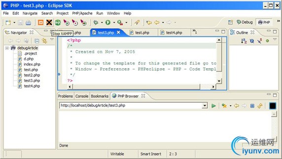

  The PHPeclipse plug-in for Eclipse is a popular tool used for developing PHP applications. Start Eclipse and specify your workspace directory as the www directory for Apache (c:\www on my machine). Now click on File > New > Project. The New Project wizard will pop up. Double-click on the PHP folder and select PHP Project. Click Next, enter a project name, debugArticle, and click Finish.
  If you set up your Web server to listen to port 80, you don't need to change anything. Otherwise, go to the Navigator window and right-click on your PHP project, debugArticle. Select Properties, then click PHP Project Settings. Click Configure Workspace Settings and change localhost appropriately or add the port your Web server is listening on (http://localhost:8080, for example). Click Apply and you're set.
  The Navigator Window should display your project and a single .project file. Right-click on your project as you did before, except this time select New > PHP File. Replace *.php with the name of the PHP file you want to create, test3.php, and click Finish. A new file should appear in the Eclipse IDE. You may have to navigate the bottom window to the PHP Browser to view the current output of your PHP file (see Figure 5).
Figure 5. The PHPeclipse plug-in for Eclipse
  Note that only Windows® users can use the PHP browser as shown in Listing 5. The exact same functionality can be used by opening up a separate browser window and pointing your browser to the directory where your test scripts are located.
  Now let's demo this application and prove its awesome capabilities.

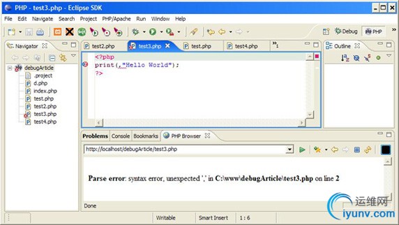

  Let's start by seeing how PHPeclipse provides you with real-time syntax parsing abilities to assist you with debugging PHP applications. To see this feature in action, start by defining the test3.php file in Eclipse, as shown below.
<?php  print(,"Hello World!");  ?>
  Notice that two characters underlined in Listing 4 get underlined in Eclipse, notifying you of incorrect syntax. Saving the file by pressing Ctrl+S displays the Parse error in Eclipse by placing a red "x" by the line that matches the parse error in your code, as shown in Figure 6.
Figure 6. Syntax error highlighting
  Now let's demo the PHP browser. This window gives you a preview of the current PHP script, as shown in Figure 6.
  Remove the comma (,) from test3.php, defined above. Save the file by pressing Ctrl+S, and watch the PHP browser window update by displaying Hello World (see Figure 7).
Figure 7. Previewing PHP scripts in PHPeclipse

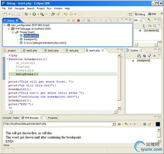

  Using the debugger, you can set breakpoints and see the browser output from your PHP code up to the breakpoint you set. You can then resume code execution and see the rest of the browser output up to the next breakpoint and the next until your PHP script has completed.
  Uncomment the lines you commented out in the php.ini file in the Setting up section and restart Apache. The debugger is loaded, and Eclipse will be able to hook into it.
  Now let's set up the debug environment in Eclipse. Create a new test4.php file and leave it empty for now. Now click Run > Debug. Select PHP DBG Script on the left-side panel and click New. Now go to the File tab, and type in your current project, debugArticle, and the file you want to debug, test4.php. Now go to the Environment tab, then to the Interpreter subtab. Browse for your php.exe file in your PHP install directory (mine is c:\apps\php5.0.3\php.exe). Now click on the Remote Debug subtab, select Remote Debug, and if you're not using Windows, uncheck the "Open with DBGSession URL in internal Browser box." Set the Remote Source path equal to the absolute path (not the Web path) to the PHP script you're going to test (I have mine set to c:\www\debugArticle\test4.php). Now click Debug.
  The Debug perspective should load, as shown in Figure 8. Otherwise, click Window > Open Perspective > Other, and select Debug.
Figure 8. Debug perspective in Eclipse
  Now you're ready to set breakpoints.

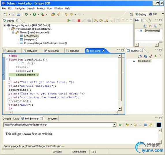

  With the versions of the plug-in and extension used in this article, a breakpoint function is required because PHP buffers output before sending it to the browser. Besides that, you need to do more than set a breakpoint to flush the current display data to your Web browser, so define your test4.php file, as shown below and in Figure 8 above.
Listing 4. Setting and creating breakpoints
  <?php  function break-point(){      ob_flush();      flush();      sleep(.1);      debugBreak();  }  print("This will get shown first, ");  print("as will this<br>");  breakpoint();  print("This won't get shown until after ");  print("continuing the break-point<br>");  breakpoint();  print("END!");  ?
  The breakpoint() function flushes output buffered and any other buffered data to the Web browser. The call to sleep(.1) is necessary so the server has enough time to flush the data out to the Web browser before code execution is halted at debugBreak(), a function known internally to the PHP debugger extension you downloaded earlier. Thus, calling breakpoint() flushes data from HTML blocks, print() and echo() statements to the browser, then halts code execution.
  After you have written the code shown in Listing 4, you can open a browser and point to test4.php or you can look at the PHP browser window (http://localhost/debugArticle/test4.php for me). Each time you type and save the file, the debugging sequence is already initiated in the PHP browser window. If you are not using Windows, look at test4.php through your browser. After saving your file, resume code execution with F8 or by clicking Run > Resume. Do this until you you see END! as the last line of output (see figures 9, 10 and 11).
Figure 9. Initial PHP browser output up to first breakpoint

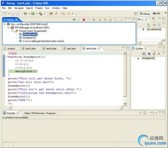

  Notice how the Debug window in Figure 9 shows the execution output as suspended.
Figure 10. PHP browser output after first breakpoint and before second breakpoint
  The Debug window in Figure 10 still shows execution as suspended and the second set of data is shown in the PHP browser.
Figure 11. Full PHP browser output
  Notice that the code is no longer suspended in the Debug window in Figure 11, and the entire script has executed, as shown in the PHP browser of Figure 11.
  Since you have witnessed the advantages of developing with PHPeclipse and the debugger extension, you'll wonder how you ever got along without it.
