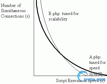

  When we talk about good performance, we are not talking about how fast your PHP scripts will run. Performance is a set of tradeoffs between scalability and speed. Scripts tuned to use fewer resources might be slower than scripts that perform caching, but more copies of the same script can be run at one time on a web server.
  In the example below, A.php is a sprinter that can run fast, and B.php is a marathon runner than can jog forever at the nearly the same speed. For light loads, A.php is substantially faster, but as the web traffic increases, the performance of B.php only drops a little bit while A.php just runs out of steam.
  Let us take a more realistic example to clarify matters further. Suppose we need to write a PHP script that reads a 250K file and generates a HTML summary of the file. We write 2 scripts that do the same thing: hare.php that reads the whole file into memory at once and processes it in one pass, and tortoise.php that reads the file, one line at time, never keeping more than the longest line in memory. Tortoise.php will be slower as multiple reads are issued, requiring more system calls.

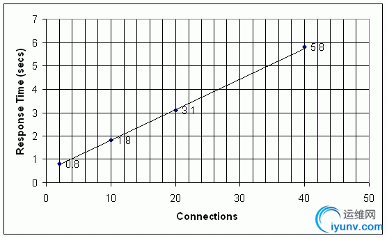

  Your network is probably the biggest bottleneck. Let us say you have a 10 Mbit link to the Internet, over which you can pump 1 megabyte of data per second. If each web page is 30k, a mere 33 web pages per second will saturate the line.
  More subtle networking bottlenecks include frequent access to slow network services such as DNS, or allocating insufficient memory for networking software.

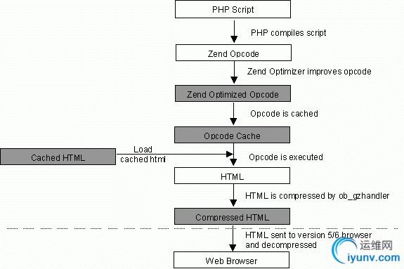

  The Zend Engine is the internal compiler and runtime engine used by PHP4. Developed by Zeev Suraski and Andi Gutmans, the Zend Engine is an abbreviation of their names. In the early days of PHP4, it worked in the following fashion:
  The PHP script was loaded by the Zend Engine and compiled into Zend opcode. Opcodes, short for operation codes, are low level binary instructions. Then the opcode was executed and the HTML generated sent to the client. The opcode was flushed from memory after execution.
  Today, there are a multitude of products and techniques to help you speed up this process. In the following diagram, we show the how modern PHP scripts work; all the shaded boxes are optional.
  PHP Scripts are loaded into memory and compiled into Zend opcodes. These opcodes can now be optimized using an optional peephole optimizer called Zend Optimizer. Depending on the script, it can increase the speed of your PHP code by 0-50%.
  Formerly after execution, the opcodes were discarded. Now the opcodes can be optionally cached in memory using several alternative open source products and the Zend Accelerator (formerly Zend Cache), which is a commercial closed source product. The only opcode cache that is compatible with the Zend Optimizer is the Zend Accelerator. An opcode cache speeds execution by removing the script loading and compilation steps. Execution times can improve between 10-200% using an opcode cache.

  One of the secrets of high performance is not to write faster PHP code, but to avoid executing PHP code by caching generated HTML in a file or in shared memory. The PHP script is only run once and the HTML is captured, and future invocations of the script will load the cached HTML. If the data needs to be updated regularly, an expiry value is set for the cached HTML. HTML caching is not part of the PHP language nor Zend Engine, but implemented using PHP code. There are many class libraries that do this. One of them is the PEAR Cache, which we will cover in the next section. Another is the Smarty template library.
  Finally, the HTML sent to a web client can be compressed. This is enabled by placing the following code at the beginning of your PHP script:

  Conversely, doubling the connections, we can predict that the average connection time should double from 1.283 to 2.566 seconds. In the benchmarks, the actual time was 2.570 seconds.
  Overload on 40 connections
  When we pushed the benchmark to use 40 connections, the server overloaded with 35% failed requests. On further investigation, it was because the MySQL server persistent connects were failing because of "Too Many Connections".
  The benchmark also demonstrates the lingering behavior of Apache child processes. Each PHP script uses 2 persistent connections, so at 40 connections, we should only be using at most 80 persistent connections, well below the default MySQL max_connections of 100. However Apache idle child processes are not assigned immediately to new requests due to latencies, keep-alives and other technical reasons; these lingering child processes held the remaining 20+ persistent connections that were "the straws that broke the Camel's back".
  The Fix
  By switching to non-persistent database connections, we were able to fix this problem and obtained a result of 5.340 seconds. An alternative solution would have been to increase the MySQL max_connections parameter from the default of 100.
  Conclusions
  The above case study once again shows us that optimizing your performance is extremely complex. It requires an understanding of multiple software subsystems including network routing, the TCP/IP stack, the amount of physical and virtual memory, the number of CPUs, the behavior of Apache child processes, your PHP scripts, and the database configuration.
  In this case the PHP code was quite well tuned, so the first bottleneck was the CPU, which caused a slowdown in response time. As the load increased, the system slowed down in a near linear fashion (which is a good sign) until we encountered the more serious bottleneck of MySQL client connections. This caused multiple errors in our PHP pages until we fixed it by switching to non-persistent connections.
  From the above figures, we can calculate for a given desired response time, how many simultaneous HTTP connections we can handle. Assuming two-way network latencies of 0.5 seconds on the Internet (0.25s one way), we can predict:
  As our client wanted a maximum response time of 5 seconds, the server can handle up to 34 simultaneous connections per second. This works out to a peak capacity of 34/5 = 6.8 page views per second.
  To get the maximum number of page views a day that the server can handle, multiply the peak capacity per second by 50,000 (this technique is suggested by the webmasters at pair.com, a large web hosting company), to give 340,000 page views a day.
