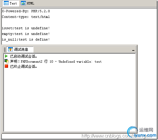

  A.一个变量没有定义,我们该怎么样去判断呢?
view sourceprint?
01<?php
02#不存在$test变量
03
04$isset= isset($test)?"test is define!":"test is undefine!";
05echo"isset:$isset\r\n";
06
07$empty=!empty($test)?"test is define!":"test is undefine!";
08echo"empty:$empty\r\n";
09
10$is_null=is_null($test)?"test is define!":"test is undefine!";
11echo"is_null:$is_null\r\n";
  测试结果是:
  结果出来了:empty,isset首先都会检查变量是否存在,然后对变量值进行检测。而is_null 只是直接检查变量值,是否为null,因此如果变量未定义就会出现错误!

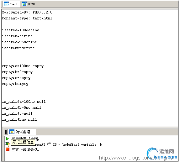

  实例:
view sourceprint?
01<?php
02$a=100;
03$b="";
04$c=null;
05//isset检查
06echo"isset","\$a=$a",isset($a)?"define":"undefine","\r\n";
07echo"isset","\$b=$b",isset($b)?"define":"undefine","\r\n";
08echo"isset","\$c=$c",isset($c)?"define":"undefine","\r\n";
09unset($b);
10echo"isset","\$b",isset($b)?"define":"undefine","\r\n";
11$b=0;
12echo"\r\n\r\n";
13
14//empty检查
15echo"empty","\$a=$a",!empty($a)?"no empty":"empty","\r\n";
16echo"empty","\$b=$b",!empty($b)?"no empty":"empty","\r\n";
17echo"empty","\$c=$c",!empty($c)?"no empty":"empty","\r\n";
18unset($b);
19echo"empty","\$b",!empty($b)?"no empty":"empty","\r\n";
20$b=0;
21echo"\r\n\r\n";
22
23//is_null检查
24echo"is_null","\$a=$a",!is_null($a)?"no null":"null","\r\n";
25echo"is_null","\$b=$b",!is_null($b)?"no null":"null","\r\n";
26echo"is_null","\$c=$c",!is_null($c)?"no null":"null","\r\n";
27unset($b);
28echo"is_null","\$b",is_null($b)?"no null":"null","\r\n";
  通过上面这个简单测试,我们可以大体知道,当一个变量存在情况下:isset,empty,is_null检测,得到值情况了。上面没有举例更多变量。其实测试发现:
