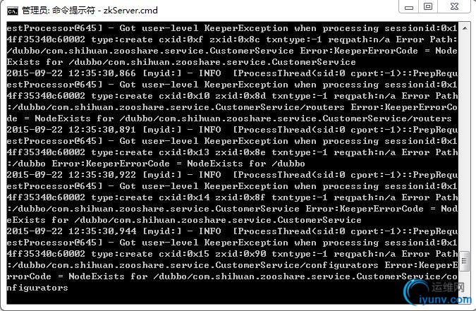

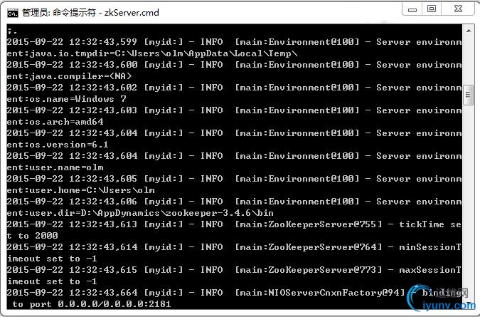

下面先来介绍安装zookeeper:
解压zookeeper-3.4.6.tar.gz到指定目录,进入zookeeper-3.4.6\conf目录并复制zoo_sample.cfg文件改名为zoo.cfg,因为zookeeper启动时默认找zoo.cfg这个文件,修改zoo.cfg文件内容如下:
# The number of milliseconds of each tick
tickTime=2000
# The number of ticks that the initial
# synchronization phase can take
initLimit=10
# The number of ticks that can pass between
# sending a request and getting an acknowledgement
syncLimit=5
# the directory where the snapshot is stored.
# do not use /tmp for storage, /tmp here is just
# example sakes.
dataDir=D:\zookeeper-3.4.6\zookeeperinstall\data
# the port at which the clients will connect
clientPort=2181
# the maximum number of client connections.
# increase this if you need to handle more clients
#maxClientCnxns=60
# Be sure to read the maintenance section of the
# administrator guide before turning on autopurge.
# http://zookeeper.apache.org/doc/current/zookeeperAdmin.html#sc_maintenance
# The number of snapshots to retain in dataDir
#autopurge.snapRetainCount=3
# Purge task interval in hours
# Set to "0" to disable auto purge feature
#autopurge.purgeInterval=1
到此zookeeper安装完毕,进入zookeeper-3.4.6\bin目录,执行zkServer.cmd或者zkServer.sh脚本就可以启动zookeeper了,例如在Windows下进入cmd命令行,D:\zookeeper-3.4.6\bin>zkServer.cmd  这里直接回车即可。

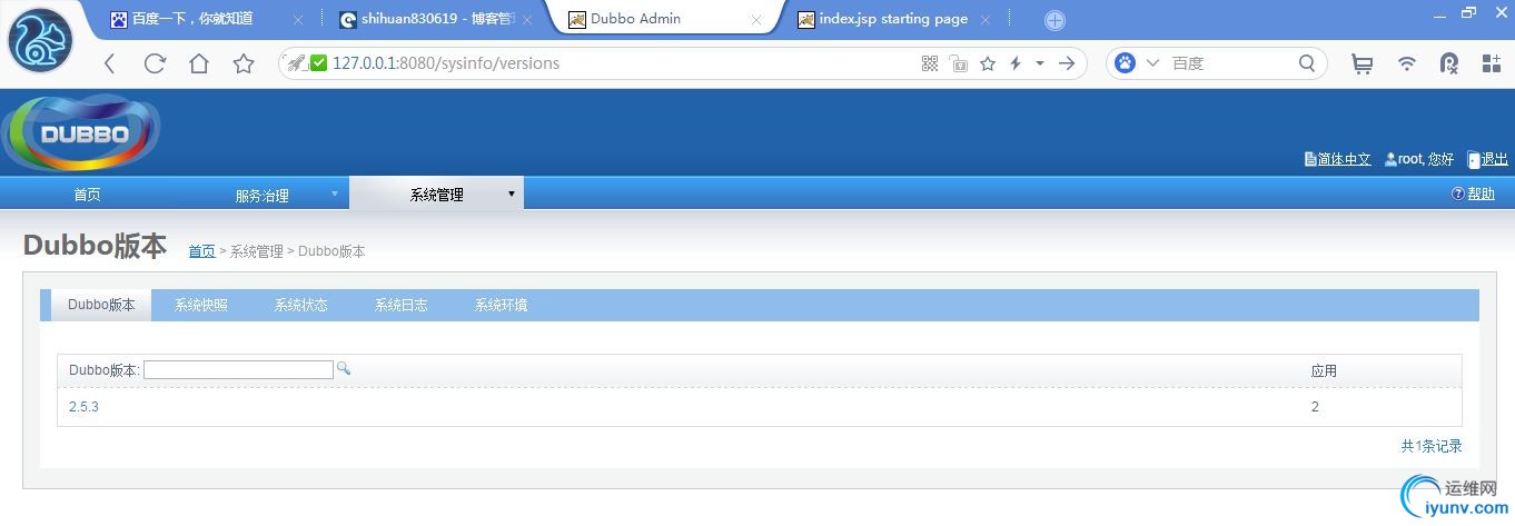

安装dubbo-admin-2.5.4.war管理控制台:

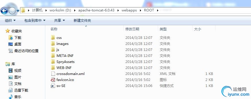

把apache-tomcat-6.0.43/webapps/ROOT目录中的所有内容全部删除掉,把dubbo-admin-2.5.4.war文件解压并把全部内容拷贝到apache-tomcat-6.0.43/webapps/ROOT目录下,如下图
修改WEB-INF目录下的dubbo.properties文件:
dubbo.registry.address=zookeeper://127.0.0.1:2181
dubbo.admin.root.password=root
dubbo.admin.guest.password=guest

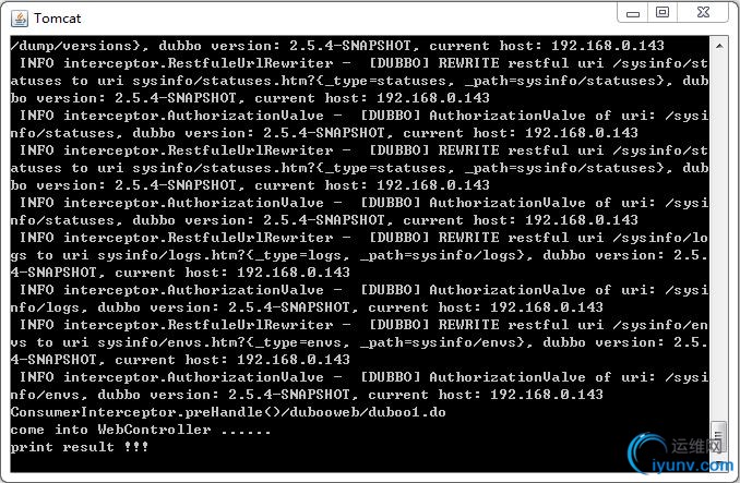

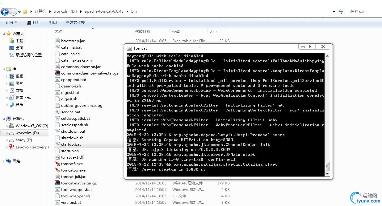

启动tomcat

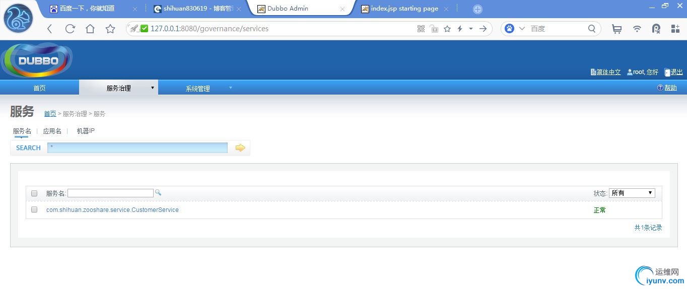

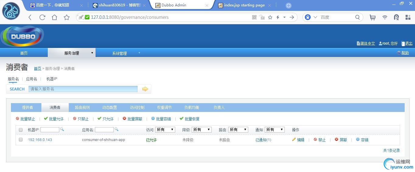

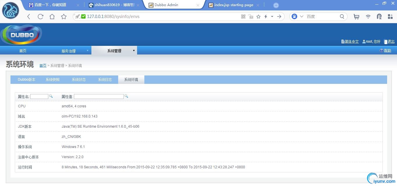

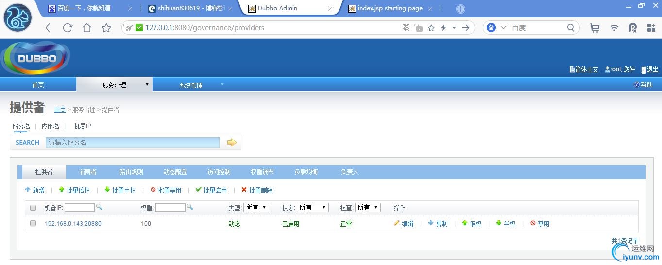

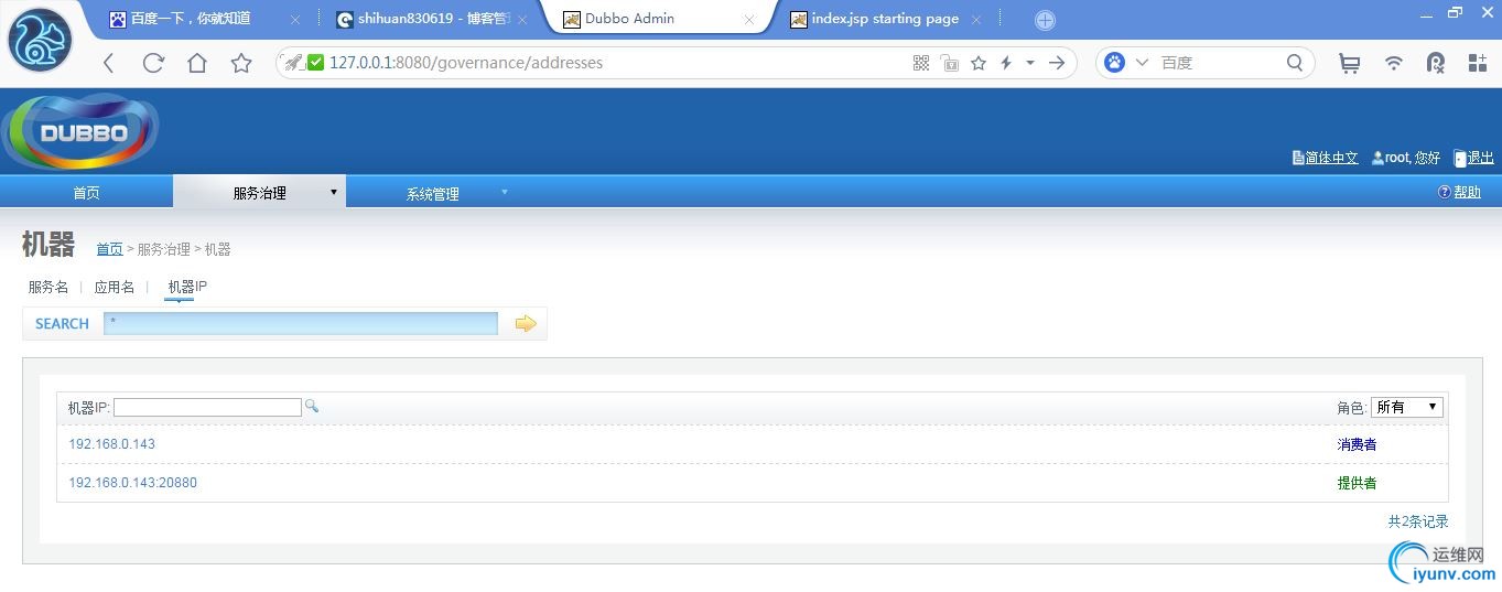

访问http://127.0.0.1:8080/governance/applications/
登录的用户名和密码都是root,不是root/guest
到此为止dubbo-admin-2.5.4.war管理控制台安装完毕。

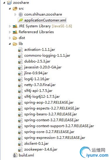

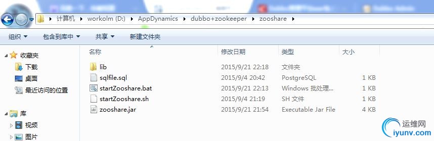

zooshare.jar服务的结构如下图所示:

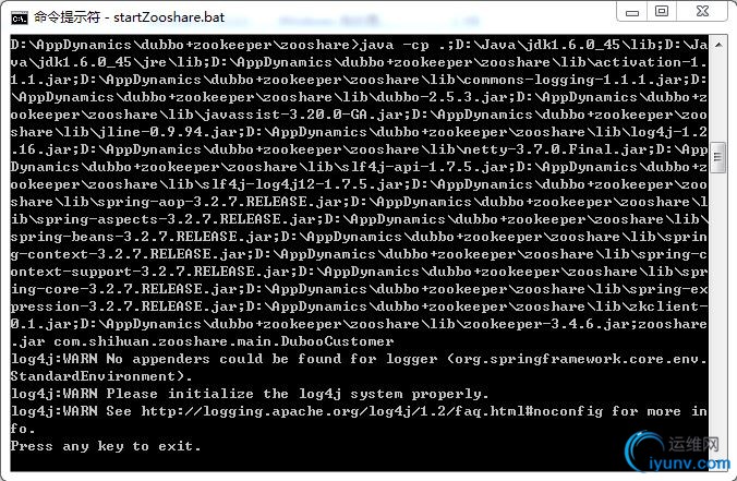

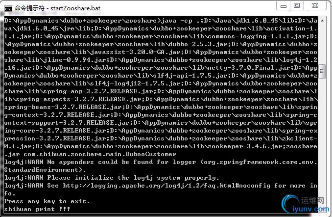

startZooshare.bat文件内容如下:
@echo off
set CURR_DIR=D:\AppDynamics\dubbo+zookeeper\zooshare
cd /D %CURR_DIR%
set JAVA_HOME=D:\Java\jdk1.6.0_45
set PATH=%JAVA_HOME%\bin;%PATH%
rem 设置变量为延迟加载
setlocal=EnableDelayedExpansion
set CLASSPATH=.;%JAVA_HOME%\lib;%JAVA_HOME%\jre\lib
for %%j in (lib\*.jar) DO (
echo %%j
set CLASSPATH=!CLASSPATH!;%CURR_DIR%\%%j
echo %CLASSPATH%
echo "#############################################"
echo %CLASSPATH%
rem set JVM_ARGS="-Xms:512m -XX:MinPermSize=128m"
rem echo JVM_ARGS=$JVM_ARGS
@echo on
java -cp %CLASSPATH%;zooshare.jar com.shihuan.zooshare.main.DubooCustomer
startZooshare.sh文件内容如下:
#!/bin/sh
export CURR_DIR=/home/zoodubbo/
cd $CURR_DIR
export JAVA_HOME=/usr/java/jdk1.6.0_45
#echo JAVA_HOME=$JAVA_HOME
export PATH=$JAVA_HOME/bin:$PATH
#echo PATH=$PATH
java -version
export CLASSPATH=$CURR_DIR/lib:$CURR_DIR:$JAVA_HOME/lib:$JAVA_HOME/jre/lib
for jarfile in `ls $CURR_DIR/lib/*.jar`
do
export CLASSPATH=$CLASSPATH:$jarfile
done
#echo CLASSPATH=$CLASSPATH
ulimit -n 400000
echo "" > nohup.out
#java org.jboss.netty.bootstrap.Bootstrap
nohup $JAVA_HOME/bin/java -cp $CLASSPATH:zoodubbo-0.0.1.jar com.shihuan.zoodubbo.C3p0TestMysql &
在Windows环境中运行cmd窗口执行startZooshare.bat就可以启动zooshare服务了。

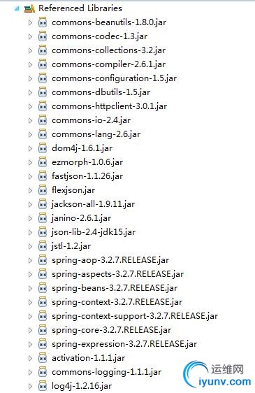

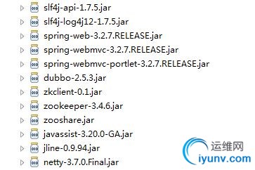

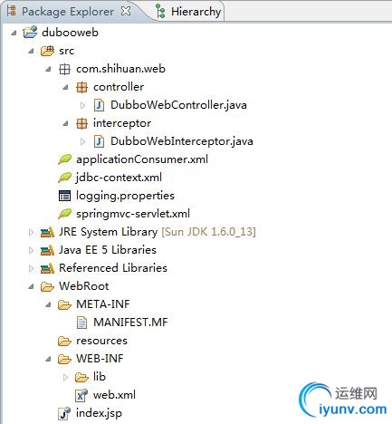

dubooweb工程所需要的jar文件截图(这里要把zooshare.jar加进来)
dubooweb工程总体结构图

DubboWebInterceptor.java文件代码如下:
package com.shihuan.web.interceptor;
import javax.servlet.http.HttpServletRequest;
import javax.servlet.http.HttpServletResponse;
import org.springframework.web.servlet.ModelAndView;
import org.springframework.web.servlet.handler.HandlerInterceptorAdapter;
public class DubboWebInterceptor extends HandlerInterceptorAdapter {
public void afterCompletion(HttpServletRequest request, HttpServletResponse response, Object handler, Exception ex) throws Exception {
super.afterCompletion(request, response, handler, ex);
public void postHandler(HttpServletRequest request, HttpServletResponse response, Object handler, ModelAndView modelAndView) throws Exception {
super.postHandle(request, response, handler, modelAndView);
public boolean preHandle(HttpServletRequest request, HttpServletResponse response, Object handler) throws Exception {
String url = request.getRequestURI();
System.out.println("ConsumerInterceptor.preHandle()" + url);
return super.preHandle(request, response, handler);
DubboWebController.java文件代码如下:
package com.shihuan.web.controller;
import org.springframework.beans.factory.annotation.Autowired;
import org.springframework.stereotype.Controller;
import org.springframework.web.bind.annotation.RequestMapping;
import com.shihuan.zooshare.service.CustomerService;
@Controller
@RequestMapping(value="/")
public class DubboWebController {
@Autowired
public CustomerService demoService;
@RequestMapping(value="duboo1")
public String duboo1(){
System.out.println("come into WebController ......");
String zoosharestr = demoService.getName();
System.out.println(zoosharestr);
return "index";
System.out.println("jinru......");
return "index";
到此为止服务消费者代码编写完毕。

】:各个模块的启动顺序不能错。
第一步:启动zookeeper服务
第二步:启动zooshare.jar服务,控制台应该输出"Press any key to exit."
第三步:启动tomcat6
第四步:访问http://127.0.0.1:8080/governance/applications/

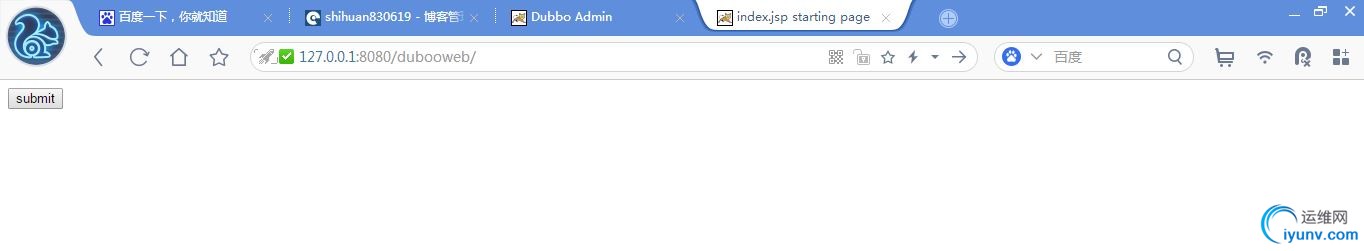

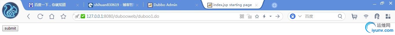

第五步:访问http://127.0.0.1:8080/dubooweb/
第六步:查看tomcat6控制台和zooshare.jar服务控制台是否有正确输出,tomcat6控制台应该输出"come into WebController ......"和"print result !!!",zooshare.jar服务控制台应该输出"shihuan print !!!"
都启动好了后,操作截图如下:
