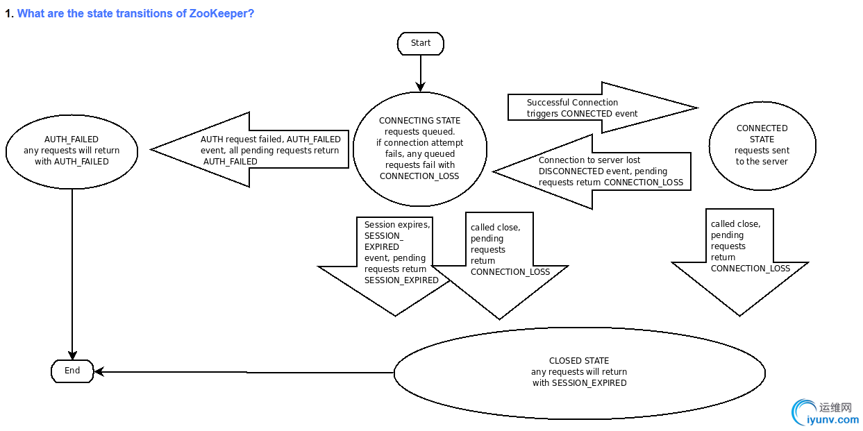

  Zookeeper的会话状态变迁图:
  Connection Loss:
