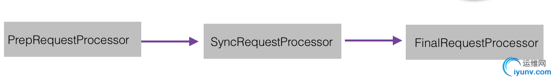

  and the request processor chains are below(only for standalone mode):
  for example,client B commit a 'getData' op on a znode with a watcher,then server will keep in mind this cnxn;then when client A post a 'delete' op on the same znode,the server will know who has registered this znode,so after the znode has been removed in server,than a 'notification' will be sent to client B immediately.
