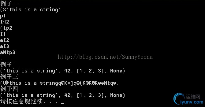

清单 1 显示了一个交互式会话,这里使用了刚才所描述的[size=0.95em]dumps()[size=0.95em]loads()函数:
# coding=utf-8
#持久存储
import cPickle as pickle
print "例子一"
t1 = ('this is a string', 42, [1, 2, 3], None)
#返回一个字符串,它包含一个 pickle 格式的对象
p1 = pickle.dumps(t1)
print p1
print "例子二"
#返回包含在 pickle字符串中的对象,即持久化存储之前的数据
t2 = pickle.loads(p1)
print t2
print "例子三"
#两者都有一个可选参数,如果为True,则该参数指定用更快以及更小的二进制表示来创建 pickle。
p2 = pickle.dumps(t1,True)
print p2
print "例子四"
t3 = pickle.loads(p2)
print t3

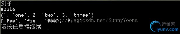

# coding=utf-8
#持久存储
print "例子一"
a1 = 'apple'
b1 = {1:'one',2:'two',3:'three'}
c1 = ['fee','fie','foe','fum']
f1 = file('temp.pkl', 'wb')
pickle.dump(a1, f1, True)
pickle.dump(b1, f1, True)
pickle.dump(c1, f1, True)
f1.close()
f2 = file('temp.pkl', 'rb')
a2 = pickle.load(f2)
b2 = pickle.load(f2)
c2 = pickle.load(f2)
print a2
print b2
print c2
f2.close()
