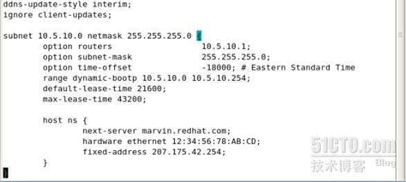

①.DHCP     #yum install -y dhcp*
                  #cp /usr/share/doc/dhcpd-config.sample  /etc/dhcpd.conf
                  #vim /etc/dhcp.conf   如下图所示

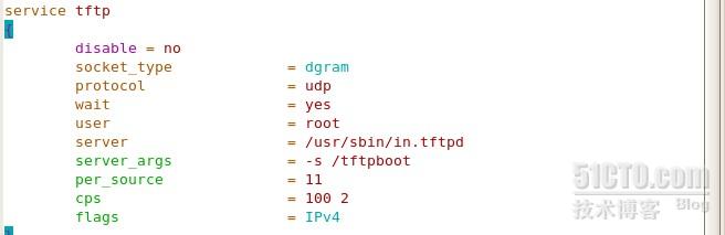

②.tftp    #yum install -y tftp*
               #vim /etc/xinetd.d/tftp   查找"disable = yes" 修改为“disable = no” 如下图所示
