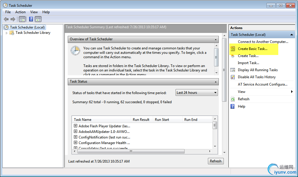

The first place to start is with the help topicScheduling
a Python script to run at prescribed times. This topic is kind of buried in the help system so it’s easy to miss. The meat of this topic shows you how to launch Window’sTask
Scheduleron various operating systems (Windows 7, XP, and so on). The screenshot below shows theTask Scheduleron Windows 7. There’s a lot
stuff you can do with the task scheduler and you’ll just have to play around with it and read the Windows help. TheActionspane, on the right,
has theCreate Basic Taskaction, and this is the place to start.

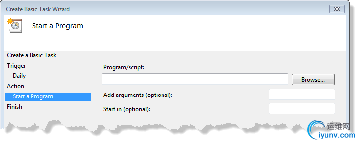

Clicking onCreate Basic Taskopens a wizard where you define the name of your task, thetrigger(when
it runs), and theaction(what program to run). The screenshot below shows theActiontab
where you specify the name of your Python script to run as well as any arguments to the script.
TheActiontab is where we have a few tips, as follows.

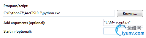

Run the Python executable with arguments
To ensure that your Python script will run regardless of the login account that the schedule task uses, and to avoid any confusion about which version of Python is used in mixed environments (64bit or 32bit), we recommend that you run the Python executable
with the name of your Python file as an argument to the executable.
Suppose the script you want to run isE:\My script.py. Instead
of running the script directly, instruct the task scheduler to runpython.exewith
the script as an argument. For example:
C:\Python27\ArcGIS10.2\python.exe "E:\My script.py"

After determining the location ofpython.exe, this is what
is entered in theActionpanel of the task scheduler:
If there are additional arguments (parameters) to your script, provide them after the path to your script. For example, the following command line executes a Python script that takes two arguments; the path to a feature class and an integer.
C:\Python27\ArcGIS10.2\python.exe "E:\My Scripts\DoConversion.py" c:\gisWork\gdb.mdb\counties 10We typically recommend writing scripts so that they take arguments like the above example rather the hard-coding dataset paths or values within the script. However, this is one case where hard-coding paths and values in your script works to
your advantage; rather than changing argument values in the task scheduler, it’s easier to just edit your script to use different paths or values.

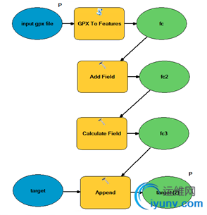

Running models at a prescribed time
A common misconception is that in order to run a model as a Python script, you must first export the model to a Python script. Geoprocessing is designed so that models are tools, just like all the tools delivered with the ArcGIS. That means you can run your
model within Python just like any other geoprocessing tool. All you need to do is import the toolbox containing your model using theImportToolboxfunction,
then run your model within Python.
For example, the model to the left imports a.gpxfile to
a geodatabase, adds a field, calculates it to the current date and time, then appends all those features into a “master” feature class.
To run this model on a schedule, all that’s needed is to execute the model within a script. Here’s the Python script to run the model:
