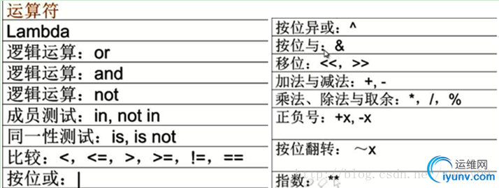

  二、变量、运算与表达式
   这里没什么好说的,有其他语言的编程基础的话都没什么问题。和Matlab的相似度比较大。这块差别不是很大。具体如下:
   需要注意的一个是:5/2 等于2,5.0/2才等于2.5。
### compute #######
# raw_input() get input from keyboard to string type
# So we should transfer to int type
# Some new support computing type:
# and or not in is < <= != == | ^ & << + - / % ~ **
print 'Please input a number:'
number = int(raw_input())
number += 1
print number**2 # ** means ^
print number and 1
print number or 1
print not number
5/2 # is 2
5.0/2 # is 2.5, should be noted
