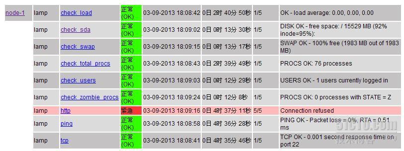

5.重启nrpe和nagios服务
客户端:
[iyunv@client ~]# killall nrpe
[iyunv@client ~]# /usr/local/nagios/bin/nrpe -c /usr/local/nagios/etc/nrpe.cfg -d
服务器:
通过-v 检查是否存在错误,若没错误则重启nagios
/usr/local/nagios/bin/nagios -v /usr/local/nagios/etc/nagios.cfg
[iyunv@server ~]# service nagios restart
Running configuration check...done.
Stopping nagios: done.
Starting nagios: done.
