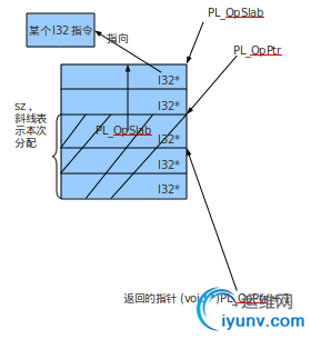

  2、分配perl片区内存
  片区大小PERL_SLAB_SIZE*sizeof(I32*),PERL_SLAB_SIZE在READONLY调试模式,默认为4096,否则为2048
  #ifdef PERL_DEBUG_READONLY_OPS
  #  define PERL_SLAB_SIZE 4096
  #  include <sys/mman.h>
  #endif
  #ifndef PERL_SLAB_SIZE
  #define PERL_SLAB_SIZE 2048
  #endif
  void *
  Perl_Slab_Alloc(pTHX_ size_t sz)
  //传入的sz参数是指分配的片区大小(字节为单位)
      dVAR;//ifdef PERL_GLOBAL_STRUCT,则完成 my_vars赋值
  //my_vars赋值:struct perl_vars*my_vars= (struct perl_vars*)PERL_GET_VARS()
  PL_OpPtr指向指令集合池中的某条I32指令的地址PL_OpSlab
  PL_OpSlab保存了具体该条I32指令地址
  PL_OpPtr和PL_OpSlab都是指针,PL_OpSlab指向某条最终指令的地址
  I32指令是一个结构变量,含有该指令的信息
  当增加某条指令时,从指令集合池中分配一个指针大小的空间存放该条指令的指针PL_OpSlab
       * To make incrementing use count easy PL_OpSlab is an I32 *
       * To make inserting the link to slab PL_OpPtr is I32 **
       * So compute size in units of sizeof(I32 *) as that is how Pl_OpPtr increments
       * Add an overhead for pointer to slab and round up as a number of pointers
      //将函数参数sz改为I32指令数量,在函数参数基础上加了2条指令
      sz = (sz + 2*sizeof(I32 *) -1)/sizeof(I32 *);

  /* We reserve the 0'th I32 sized chunk as a use count */
          //PL_OpSlab从PL_OpPtr获得指令地址
          PL_OpSlab = (I32 *) PL_OpPtr;
  /* Reduce size by the use count word, and by the size we need.
  * Latter is to mimic the '-=' in the if() above
          //PL_OpSpace 为余下的空间,重新计算
  PL_OpSpace = PERL_SLAB_SIZE - (sizeof(I32)+sizeof(I32 **)-1)/sizeof(I32 **) - sz;
  /* Allocation pointer starts at the top.
    Theory: because we build leaves before trunk allocating at end
    means that at run time access is cache friendly upward
          //PL_OpPtr指向片区空间(即指令指针池)的未尾,因为空间容纳了PERL_SLAB_SIZE个I32指令结构地址(I32*)
  PL_OpPtr += PERL_SLAB_SIZE;
  //处理在只读调试的情况下,新增片区,需要放置相关片区地址在PL_slabs数组中(仅用于调试),该数组存放了所有曾经分配过的OP片区,注意不是PL_OpSlab
  /* We remember this slab.  */
  /* This implementation isn't efficient, but it is simple. */
  PL_slabs = (I32**) realloc(PL_slabs, sizeof(I32**) * (PL_slab_count + 1));
  PL_slabs[PL_slab_count++] = PL_OpSlab;
  DEBUG_m(PerlIO_printf(Perl_debug_log, "Allocate %p\n", PL_OpSlab));
  #endif
      assert( PL_OpSpace >= 0 );//确保PL_OpSpace还有空间容纳I32指令
     //新分配空间或原有空间已经足够容纳,处理返回值(void *)(PL_OpPtr + 1)
      /* Move the allocation pointer down */
      PL_OpPtr   -= sz;//分配片区空间的使用是从未尾开始向前推进,即从后向前使用空间,PL_OpPtr指向本次从片区空间中分配的指令集合所使用的空间的起始地址
      assert( PL_OpPtr > (I32 **) PL_OpSlab );//确保本次分配的指令集合空间够用,
  //没有超过片区的起始地址(I32 **) PL_OpSlab
     //本次分配的空间起始地址放置片区空间首指令( I32*)PL_OpSlab
      *PL_OpPtr   = PL_OpSlab; /* Note which slab it belongs to */
  //PL_OpSlab是(I32*)
     (*PL_OpSlab)++; /* Increment use count of slab */
      assert( PL_OpPtr+sz <= ((I32 **) PL_OpSlab + PERL_SLAB_SIZE) );
      assert( *PL_OpSlab > 0 );
      return (void *)(PL_OpPtr + 1);//因为*PL_OpPtr处放置了片区空间首指令PL_OpSlab,必须以下一个指令指针位置,返回给函数调用者
