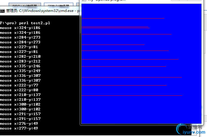

#!/usr/bin/perl -w
use strict;
use warnings;
use OpenGL qw/ :all /;
use OpenGL::Config;
glutInit();
glutInitDisplayMode(GLUT_RGB|GLUT_SINGLE);
glutInitWindowPosition(100,100);
glutInitWindowSize(400,400);
glutCreateWindow("my  OpenGL program");
glClearColor(0,0,100,255);
glClear(GL_COLOR_BUFFER_BIT);
glMatrixMode(GL_PROJECTION);
glLoadIdentity();
gluOrtho2D(-200,200,-200,200);
glMatrixMode(GL_MODELVIEW);
glutDisplayFunc(\&mydis);
glutMouseFunc(\&mymouse);
glutMainLoop();
sub mymouse()
my ($button,$state,$myx,$myy)=@_;
if ($button==GLUT_LEFT_BUTTON  and $state==GLUT_DOWN)
glPointSize(3);
glBegin(GL_LINES);
glColor3f(255,0,0);
glVertex2f($myx-200,200-$myy);
glVertex2f(-200,200-$myy);
glEnd();
glFlush();
print "mouse x:$myx-y:$myy\n";
sub mydis()
glPointSize(3);
glFlush();
