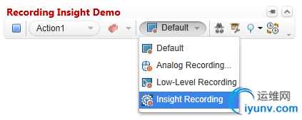

  In order to activate Insight during a record session, change the Recording Mode selection to Insight Recording:
  While in the Insight Recording mode, mouse operations will create an Insight step. Keyboard actions, on the other hand, create WinObject.Type steps. The reasoning behind this is that when a mouse event occurs there are coordinates associated with it and UFT can try to understand which object was acted upon, based on the coordinates. Typing presents more of a problem since UFT cannot, in general, determine which object is in focus. Therefore, the text is associated with the top-level window in focus, for example:
  Window("Calculator").WinObject("Text").Type "3"
  The InsightObject does support the Type operation. You can use this method in a test to move the focus to a specific InsightObject before typing.

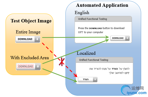

  Exclude Areas
  There are cases in which a UI control contains areas that change without affecting the functionality of the control, and therefore make the image less useful for identification purposes. Such areas may change at random (e.g. advertisements), be dynamically generated (e.g. weather forecasts), or contain text which is localized to different languages. By adding Excluded Areas to the image we can specify that only parts of the captured image should be matched against the application, and the other areas can safely be ignored:
