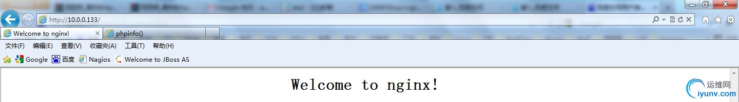

1.启动nginx
/usr/local/nginx/sbin/nginx

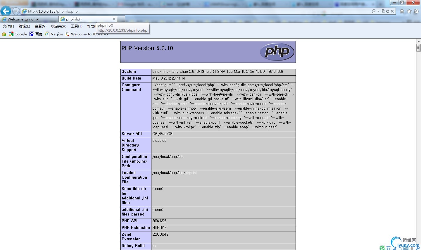

  5.测试nginx
vi /usr/local/nginx/html/phpinfo.php
phpinfo();
  6.测试结果
  phpinfo()
