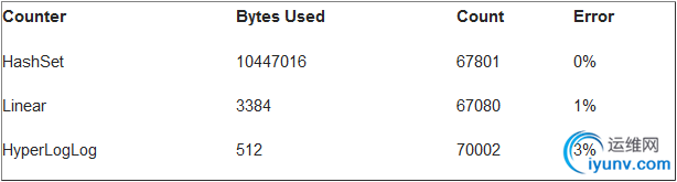

  基数估计算法就是使用准确性换取空间。为了说明这一点,我们用三种不同的计算方法统计所有莎士比亚作品中不同单词的数量。请注意,我们的输入数据集增加了额外的数据以致比问题的参考基数更高。这三种技术是:Java HashSet、Linear Probabilistic Counter以及一个Hyper LogLog Counter。结果如下:
  该表显示,我们统计这些单词只用了512 bytes,而误差在3%以内。相比之下,HashMap的计数准确度最高,但需要近10MB的空间,你可以很容易地看到为什么基数估计是有用的。在实际应用中准确性并不是很重要的,这是事实,在大多数网络规模和网络计算的情况下,用概率计数器会节省巨大的空间。

  Cardinality estimation algorithms trade space for accuracy. To illustrate this point we counted the number of distinct words in all of Shakespeare's works using three different counting techniques. Note that our input dataset has extra data in it so the cardinality is higher than the standard reference answer to this question. The three techniques we used were Java HashSet, Linear Probabilistic Counter, and a Hyper LogLog Counter. Here are the results:
  Counter
  Bytes Used
  Count
  Error
  HashSet
  10447016
  67801
  0%
  Linear
  3384
  67080
  1%
  HyperLogLog
  512
  70002
  3%
  The table shows that we can count the words with a 3% error rate using only 512 bytes of space. Compare that to a perfect count using a HashMap that requires nearly 10 megabytes of space and you can easily see why cardinality estimators are useful. In applications where accuracy is not paramount, which is true for most web scale and network counting scenarios, using a probabilistic counter can result in tremendous space savings.
