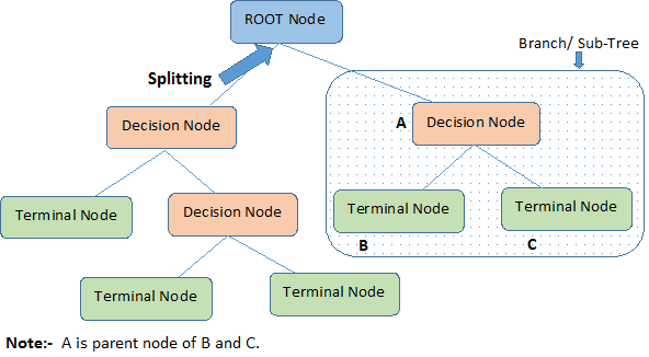

Important Terminology related to Decision Trees
  Let’s look at the basic terminology used with Decision trees:
  • Root Node: It represents entire population or sample and this further gets divided into two or more homogeneous sets.
  • Splitting: It is a process of dividing a node into two or more sub-nodes.
  • Decision Node: When a sub-node splits into further sub-nodes, then it is called decision node.
  • Leaf/ Terminal Node: Nodes do not split is called Leaf or Terminal node.
  • Pruning: When we remove sub-nodes of a decision node, this process is called pruning. You can say opposite process of splitting.
  • Branch / Sub-Tree: A sub section of entire tree is called branch or sub-tree.
  • Parent and Child Node: A node, which is divided into sub-nodes is called parent node of sub-nodes where as sub-nodes are the child of parent node.
  These are the terms commonly used for decision trees. As we know that every algorithm has advantages and disadvantages, below are the important factors which one should know.

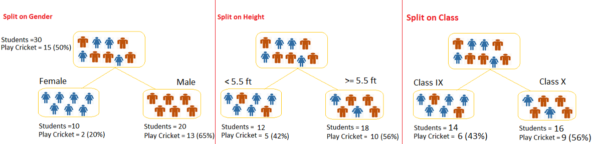

  Example: – Referring to example used above, where we want to segregate the students based on target variable ( playing cricket or not ). In the snapshot below, we split the population using two input variables Gender and Class. Now, I want to identify which split is producing more homogeneous sub-nodes using Gini index.
Split on Gender:
  • Calculate, Gini for sub-node Female = (0.2)*(0.2)+(0.8)*(0.8)=0.68
  • Gini for sub-node Male = (0.65)*(0.65)+(0.35)*(0.35)=0.55
  • Calculate weighted Gini for Split Gender = (10/30)*0.68+(20/30)*0.55 = 0.59
  Similar for Split on Class:
  • Gini for sub-node Class IX = (0.43)*(0.43)+(0.57)*(0.57)=0.51
  • Gini for sub-node Class X = (0.56)*(0.56)+(0.44)*(0.44)=0.51
  • Calculate weighted Gini for Split Class = (14/30)*0.51+(16/30)*0.51 = 0.51
  Above, you can see that Gini score for Split on Gender is higher than Split on Class, hence, the node split will take place on Gender.

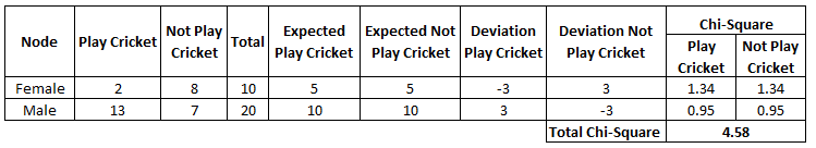

  Example: Let’s work with above example that we have used to calculate Gini.
  Split on Gender:
  • First we are populating for node Female, Populate the actual value for “Play Cricket” and“Not Play Cricket”, here these are 2 and 8 respectively.
  • Calculate expected value for “Play Cricket” and “Not Play Cricket”, here it would be 5 for both because parent node has probability of 50% and we have applied same probability on Female count(10).
  • Calculate deviations by using formula, Actual – Expected. It is for “Play Cricket” (2 – 5 = -3) and for “Not play cricket” ( 8 – 5 = 3).
  • Calculate Chi-square of node for “Play Cricket” and “Not Play Cricket” using formula with formula,= ((Actual – Expected)^2 / Expected)^1/2. You can refer below table for calculation.
  • Follow similar steps for calculating Chi-square value for Male node.
  • Now add all Chi-square values to calculate Chi-square for split Gender.
  Split on Class:
  Perform similar steps of calculation for split on Class and you will come up with below table.
Above, you can see that Chi-square also identify the Gender split is more significant compare to Class.

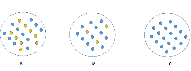

Information Gain:
  Look at the image below and think which node can be described easily. I am sure, your answer is C because it requires less information as all values are similar. On the other hand, B requires more information to describe it and A requires the maximum information. In other words, we can say that C is a Pure node, B is less Impure and A is more impure.
  Now, we can build a conclusion that less impure node requires less information to describe it. And, more impure node requires more information. Information theory is a measure to define this degree of disorganization in a system known as Entropy. If the sample is completely homogeneous, then the entropy is zero and if the sample is an equally divided (50% – 50%), it has entropy of one.
  Entropy can be calculated using formula:-
  Here p and q is probability of success and failure respectively in that node. Entropy is also used with categorical target variable. It chooses the split which has lowest entropy compared to parent node and other splits. The lesser the entropy, the better it is.
  Steps to calculate entropy for a split:
  • Calculate entropy of parent node
  • Calculate entropy of each individual node of split and calculate weighted average of all sub-nodes available in split.
  Example: Let’s use this method to identify best split for student example.
  • Entropy for parent node = -(15/30) log2 (15/30) – (15/30) log2 (15/30) = 1. Here 1 shows that it is a impure node.
  • Entropy for Female node = -(2/10) log2 (2/10) – (8/10) log2 (8/10) = 0.72 and for male node,  -(13/20) log2 (13/20) – (7/20) log2 (7/20) = 0.93
  • Entropy for split Gender = Weighted entropy of sub-nodes = (10/30)*0.72 + (20/30)*0.93 = 0.86
  • Entropy for Class IX node, -(6/14) log2 (6/14) – (8/14) log2 (8/14) = 0.99 and for Class X node,  -(9/16) log2 (9/16) – (7/16) log2 (7/16) = 0.99.
  • Entropy for split Class =  (14/30)*0.99 + (16/30)*0.99 = 0.99
  Above, you can see that entropy for Split on Gender is the lowest among all, so the tree will split on Gender. We can derive information gain from entropy as 1- Entropy.
