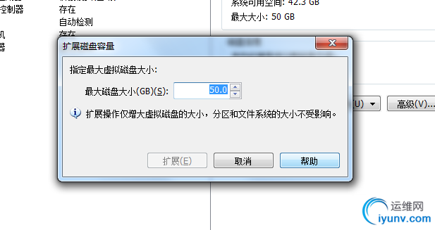

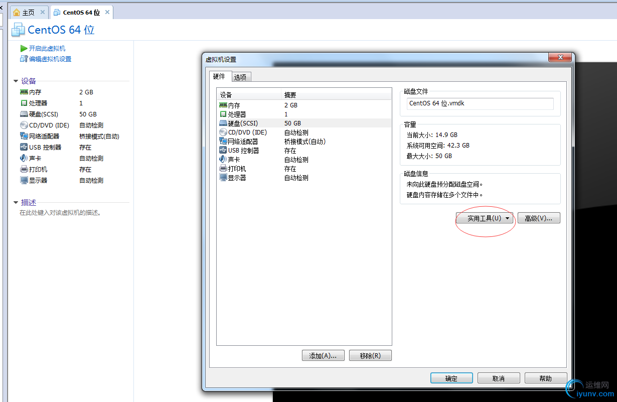

  硬盘空间为20G,VMware增加磁盘大小,需要再增加10G空间

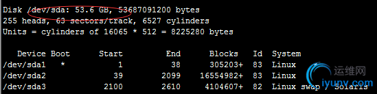

  扩展完后,重启系统,再次使用fdisk -l查看,会发现硬盘空间变大了;

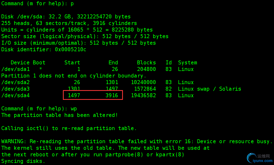

   Device Boot      Start         End      Blocks   Id  System
/dev/sda1   *           1          26      204800   83  Linux
Partition 1 does not end on cylinder boundary.
/dev/sda2              26        1301    10240000   83  Linux
/dev/sda3            1301        1497     1572864   82  Linux swap / Solaris
/dev/sda4            1497        3916    19436582   83  Linux
Command (m for help): wp       #保存并退出,如果创建有误,直接退出不要保存即可The partition table has been altered!
Calling ioctl() to re-read partition table.
WARNING: Re-reading the partition table failed with error 16: Device or resource busy.
The kernel still uses the old table. The new table will be used at
the next reboot or after you run partprobe(8) or kpartx(8)
Syncing disks.
